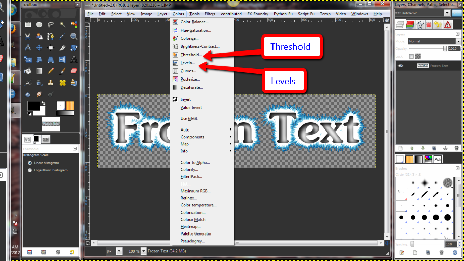

Molly here is where you will find the levels and threshold filters
This is an image of the levels filter
This is how to apply the threshold filter
I hope this is of help to you :hi5
