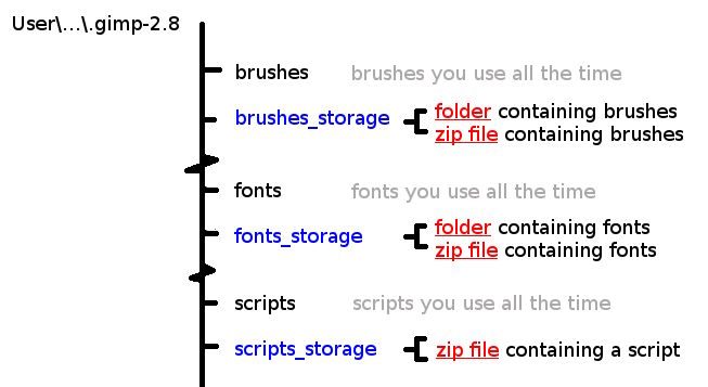

Just make sure the brushes/fonts/scripts/patterns....in each something_storage
are in sub-folders or zipped.
edit: Still not so clear. You can of course have more than one sub-folder or zip file or combination of each

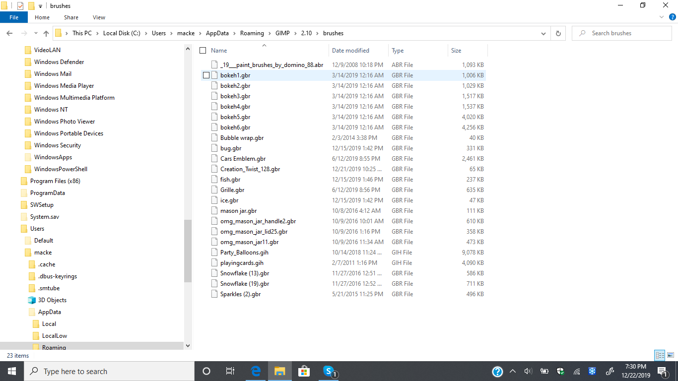

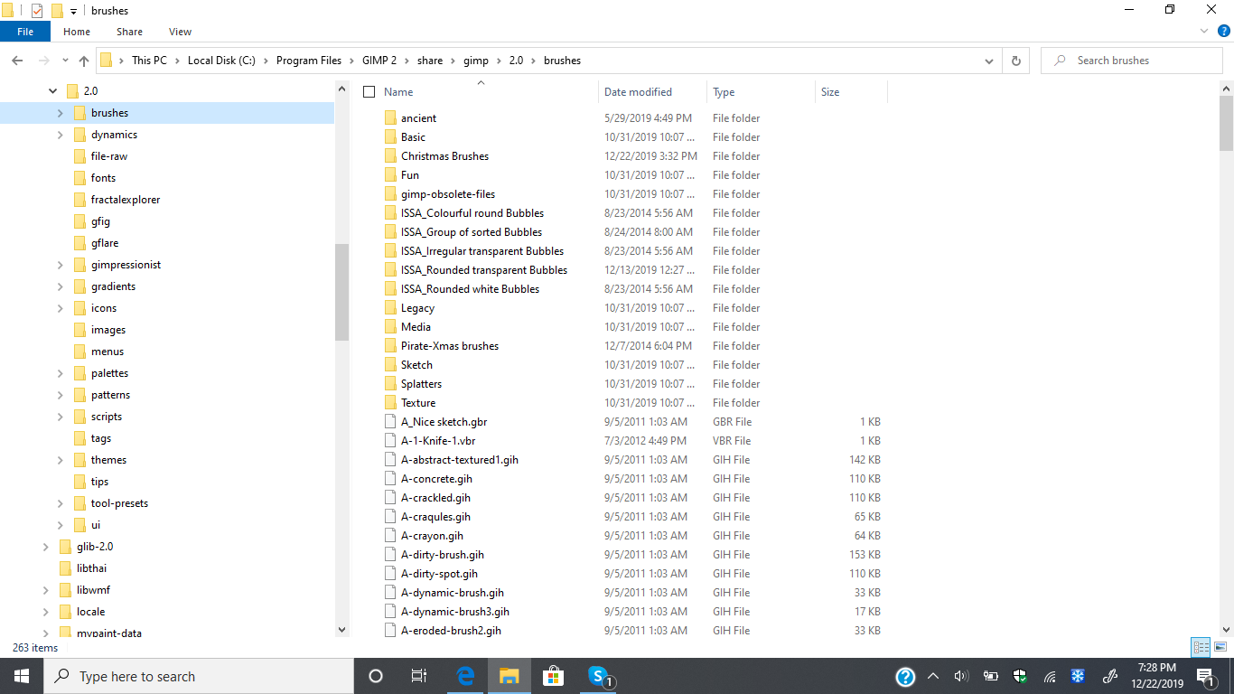

I have the addonCollection Manager but which folder do I go to for the brushes? It is both folders? I'm on Windows 10 64 bit.
 Post subject: Re: Setting up your addonCollection Manager Tutorial
PostPosted: Mon Dec 23, 2019 12:04 am  (#14)
Program Files/GIMP 2/share/... folders should be reserved to Gimp itself.
The user deals with User/... folders.
Having addonsCollectionManager the user adds new folders under .../brushes_storage, then manages her/his collection using aCM to "activate" (or "deactivate") them, which means aCM will copy (remove) into (from) ...brushes.

Oh, okay. The reason I asked is because sometimes the User folder doesn't read the brushes and the share folder does.. that's where I have folders of brushes.

All your 3rd party brushes, gradients plugins, scripts, etc... should go in your users GIMP 2.10 folder. Looking at the image you provided, you should move your addons to the User folder. Don't mess around with the Program folder "GIMP 2" and don't add anything there. This is how you User GIMP 2.10 should look:
When you create the folder for the addOnCollectionManager plugin, you folders should look like this . You Have to create an individual "_storage" folder for this items:
