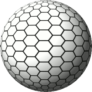

This is not really a tutorial. Just a trick to make it the right way.
Mapping objects to sphere in Filters>Map>Map Object yields rather horrible results as the image you are
mapping appears to be stretched along parallels of the sphere.
How to diminish the distortion and get more or less right proportions?
To get my point clearer I'm attaching these 2 images, one with strong distortion and the other with more or less correct proportions.
Image Image
(The original image from DA)
Both images were created in Map Object with identical settings from the same size image with face
The only difference is how you 'prepare' the image to be mapped.
I've found empirically that objects to be mapped should be 'squeezed' from sides by the factor of 1.5 (may not work for any object
but in most cases it does)
How we do it?
Let's say, you want a sphere with mapped object to be around 700 x 700 pixels in size.
Bear in mind that mapping objects to sphere will produce a sphere which is half the size of your original image.
Therefore, our image should be about 1400 x 1400 pixels before mapping.
I used Hexacol BW pattern for better visualization. Here are the results.
The image on the right was made from 1440 x 1440 square without prior 'treatment'
To get the left image I created an image with 1440 px Height and 1440*1.5 Width. We get 2160 x 1440 pixel image
(yes, unlike 2.6 in GIMP 2.8 you can enter common mathematical operations [+ * / -] for height and width) and then filled it
with Hexacol BW pattern.
Scale the image to the desired 1440 x 1440 square as shown at the picture below.
Don't forget to unchain before you enter the width and use Lanczos interpolation
Our pattern becomes 'sqeezed' from the sides.
Here's our face after such a treatment
Now you can map it to sphere to get less distorted results.
Thanks for reading.

It's quite simple. Get your square image with pattern cooked as described. This is going to be your background layer.
To make the animation you need to create 12 frames out of it.
In map object change only the following settings:
1. Options: Sphere, Transparent background, Create new layer
2. Light: No light
3. Material: Specular 0.00
4. Orientation: Rotation Z 35.0 degrees
Then click OK. Your 1st frame is ready.
Select your BG Layer again.
For each next frame change only Rotation Y by 1 degree.
When you come down to making Rotation Y to 11 degrees this must be your 12th frame.
Delete your background layer. Animation is ready.
P.S. N of frames depends on the complexity of pattern. Some patterns require 12 frames, some 18.
But in most cases 8, 6 or even 3 frames is enough. The general rule here: 360 must be divisible by N.
Edit. Forgot to mention, when you save this animation as GIF set frame delays to 20ms.
