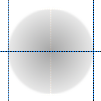

Your guides should be arranged as shown in the image below.
Add a New Layer to the image (Layer | New Layer) and name the layer Moon.

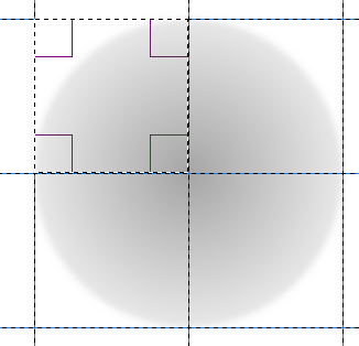

Select the Ellipse Select Tool.
In the Tool Options Dialog window for the Ellipse Select Tool, make sure that the following are checked (activated): Antialiasing, Feather edges (use a Radius value of 10.0), Expand From Center, Fixed Aspect Ratio and make sure the Aspect Ratio is 1:1.
Place your mouse cursor at the point where the two center guidelines intersect in the middle of the screen at x,y position 200,200. Hold down your left mouse button and drag the mouse cursor down and towards the left until the circular selection is touching all four outer guidelines as shown below:
Change the Foreground Color to a5a5a5 and the Background Color to e9e9e9
Select the Blend Tool. For the Tool Options for the Blend Tool, set Shape to Radial.
Place your mouse cursor at the point where the two center guidelines intersect at the middle of the image and hold down your left mouse button while dragging it to the right along the middle horizontal guideline until you reach the far right vertical guideline.
Then select
Select | None
The circular selection will now have a gradient fill as shown below:
That will be used as the moon object in the animation.

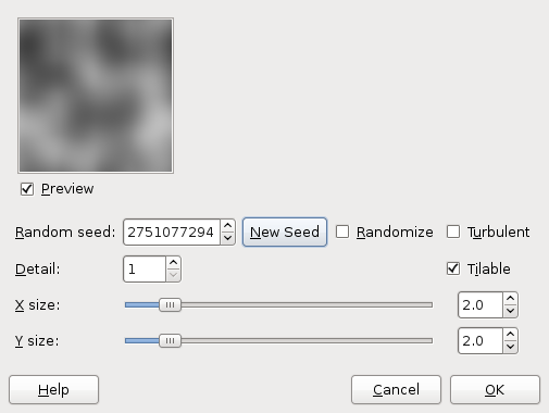

Filters | Render | Clouds | Solid Noise
As shown above, set the X size and Y size each to 2.0.
Activate Tilable.
Click New Seed until you end up with a design you like.
Click OK.

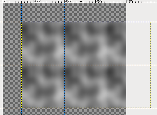

Duplicate the Clouds Layer and using the Move Tool, move it down to the square below bound by the outer and center guidelines:
Place your mouse cursor inside the Layers Dialog window over the Clouds Copy Layer and right-click and from the menu that opens select Merge Down. You will then have a rectangular Clouds Layer as shown below:
Duplicate that Layer twice.
Using the Move Tool, move Clouds Copy#1 of the duplicated Layers over to the right to be bounded by the vertical center and outer guidelines and the two outer horizontal guidelines as shown below:
Move Cloud Copy, the other duplicated Layer so that it's left side is touching the outer Vertical guideline. It will extend beyond the boundary of the image boundary as shown below:
In the Layers Dialog Window turn off the visibility (eyeball icons) of all Layers except for the three Cloud Layers:
In the Layers Dialog Window, right-click on one of the visible Cloud Layers and from the menu that opens select Merge Visible Layers.
In the Dialog Box that opens, accept the default of Expand as necessary.
Then click on Merge.

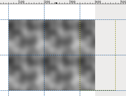

Your final Clouds Layer will now look like this in your image window:
In the above image, notice the yellow dotted outline showing the border of the Cloud Layer after the merge.

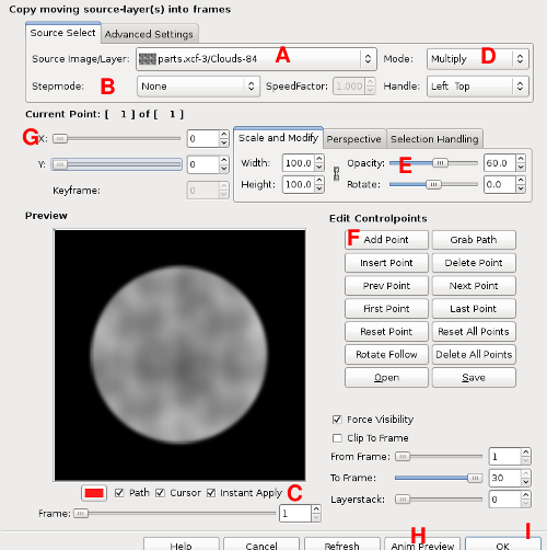

Select Video | Move Path
This time we set up the clouds moving past the moon.
1.) Set Source Image/Layer (A) to Clouds
2.) Set Stepmode (B) to None
3.) Activate Instant Apply ( C ) It's always good to see the effect of changes real time.
4.) Set the Mode (D) to Multiply
5.) Set the Opacity (E) value to 60.0
6.) Click once on the Add Point Button (F)
7.) Double-click inside the X position (G) white text box and change the zero to -140 (minus 140). Then click either your TAB key or Enter key to set this value in memory.
8.) Click on the Anim Preview Button (H). In the small window that opens, select Exact Object On Frames. Change the Framerate to 10.0.
9.) When you watch the animation, you will see the clouds slowly moving across the moon. When you are finished watching the preview, close out the preview window and the little image file that GAP creates. Select Don't Save.
10.) If the preview looked OK, click OK (I) in the Move Path window.

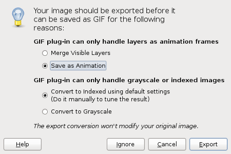

Save your optimized animated image file as clouds_over_moon.gif, or whatever name you want. Just make sure to use the .gif suffix at the end of the filename. Then click Save.
The Export Dialog window will open. Make sure that you set it to Save As Animation:
Click on the Export button.
Another Save window will open, just accept the default options and click Save.

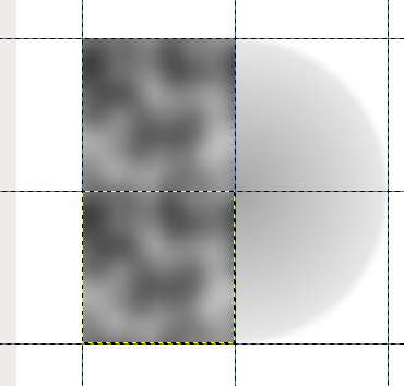

To answer your question about not knowing where the dupes go, the tutorial shows you an image of where to place the second dupe after you make the first small Cloud Layer:
In the above image, see the square just below where the first square Cloud Layer was? That is where you place the Cloud Layer Copy.
You then Merge it Down on to the Cloud Layer.
Then you duplicate that new layer now called Cloud two times.
I then explain in the tutorial how to arrange each of the two Cloud Layer duplicates and to then merge them together to give you one long layer. Once you arrange them (and before they are merged together), part of the layer that is to the far right is going to lay beyond the border of the image window. It will still be there, but all that Gimp will show is a small part of that layer being visible:
Notice the gray region on the right of the image above? That is right side border of the image. Notice how the last layer's yellow dotted lines extends beyond that border? Only a small part of it shows as visible. The rest is still there, but it is beyond the border of the image window, so you just cannot see it.
Once the three layers are arranged as shown above, they can be merged together. I changed the tutorial to have you turn off visibility of all the other layers except the Cloud Layers and to right-click inside the Layers Dialog Window and select Merge Visible Layers.

Finally figured it out. Think there might be a step missing from the tutorial.
Molly, if you are still stuck try clicking the "Add Point" button after you enter the "-120" value in X. That resolved my issue.
 Post subject: Re: Cloudy Foreboding Moon Animation
PostPosted: Tue Nov 01, 2011 1:03 pm  (#16)
ok Mike, that is what I was wondering. I have everything going right up to that point and then it screws up. Did you click the add point before and after, or just the once?
EDIT: I tried that Mike. I got closer this time BUT the playback just does about a quarter turn then stops between each turn. The steps below are where I am stuck, I get that far and something in there screws me up
6.) In order for there to be animation, things need to appear to move from one point to another. With the above options and leaving all other settings at default in Move Path, we have just set the first animation point. We must now set the ending point for the animation. To do so click once on the Add Point Button (F). This animation only needs a starting and ending point. More complex animations will have multiple points.
7.) OK, we created our ending point, so what do we want to change. We are going to have the Cloud Layer move across the moon layer. The original Cloud layer was a small square, it's dimensions were 140x140. When it was created by the Solid Noise filter, it was made tileable, meaning it had a repeatable pattern, so that if you placed two or three side by side, top to bottom, and shifted them by the amount of the original layer, 140, it would all look the same. That is what we do here, so double-click inside the X position (G) white text box and change 1.) the zero to -140 (minus 140). Then click either your TAB key or Enter key to set this value in memory.

I clicked "Add Point" both per the tutorial and immediately after entering "-140" and pressing the Tab key once.
I also had 16 frames and found I had to delete frame #16 to obtain a smooth animation.
I am just blindly guessing but it is possible that your first and last frames are identical which would give the appearance of "stopping." You might try deleting the last frame and running the animation preview. That should give an indication as to whether or not I have any idea what I'm talking about here. :D

Ok Mike,
I forgot to click the tab this time. I was also so upset that it didn't work after 3 days trying I deleted it. I will try those after supper, I am in the midst of cooking (UGH) right now. I will post back and let you know after supper how I make out. thank you.
Edit:
I did the whole thing again. I added the point in the second move path, then changed the X to -140, then pressed add point again then pressed the tab key once, (in that order)
After I finished, I played it back and it still stops, before and after I deleted a frame. I am going to start it one more time then I will give up until those two steps are more clear to me.

I finally after 4 days got it solved. I didn't click the add point twice, I pressed enter instead of tab for record the -140 X. That is the only thang I did differently. Anyway, it worked and I am happy :gimp
