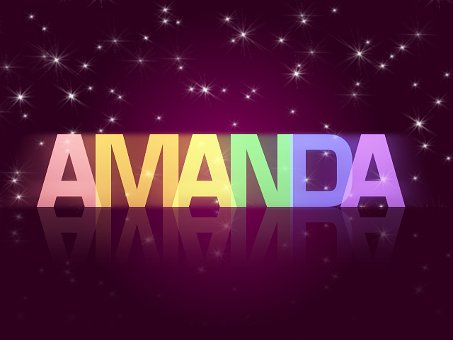

Posts: 155
I decided to add some stars. I think I put stars in everything I do... :P
Is it just me, or does saving and/or uploading degrade the quality a little? I swear the radial gradient part in the middle looked a lot smoother in GIMP. Grr.
Very pretty Amanda.
Could be the browser or Internet.
Something you may want to try ... when I want to check how an image looks without having the window "dressings" around it is click Filters > Animation > Playback and click the detach button in the playback dialog. Then click on the webpage where the image is and you can compare the two. You can move the detached picture around. This way you have the advantage of your image still being in GIMP.
