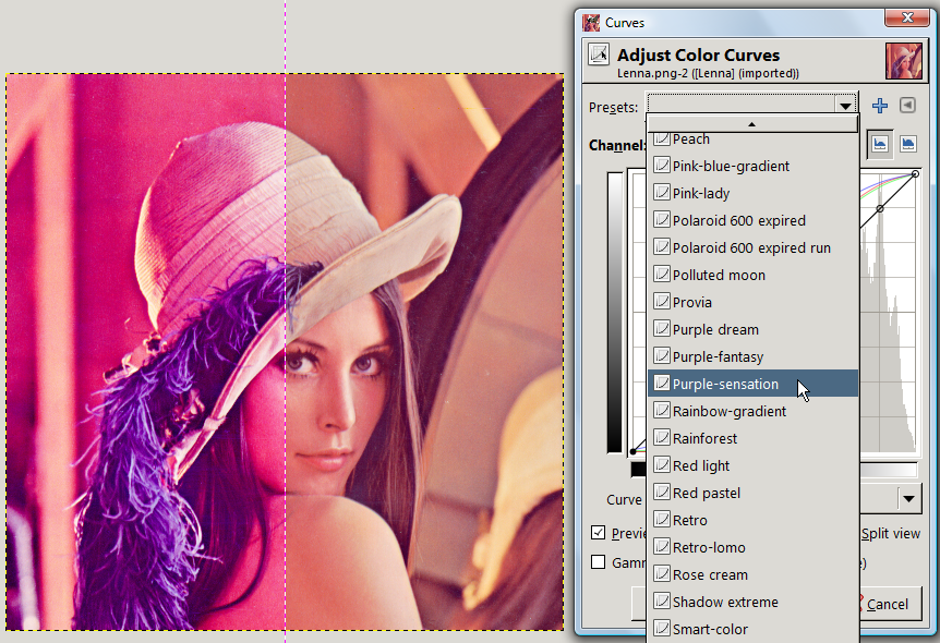

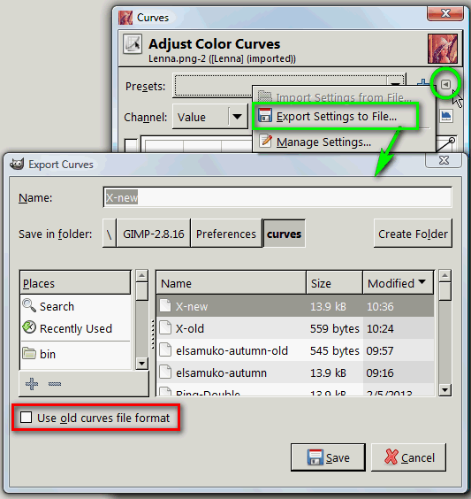

 Post subject: Re: How to add a bunch of Curves presets at once in Linux
PostPosted: Sat Sep 03, 2016 4:15 am  (#8)
Thanks for sharing.
It works well in Windows - also for Gimp 2.9.5
Only one note;
There are two ways of recording curves - old will not show up in the list - but you can open it and add to favorites.

MareroQ wrote:
Thanks for sharing.
Only one note;
Glad it works on other systems. Good to know my efforts weren't wasted.
Only two of the curves in that file are mine and they came straight from the original .settings file. So I don't quite understand what you mean about recording them differently. Or is that why the few "bad" presets didn't work?

PostPosted: Sat Sep 03, 2016 10:53 am  (#10)
There are curves in the file that have been commented out ("Corssprocess", "Elsamuko-autumn", "Elsamuko-blue", "Elsamuko-green", "Portra", "Provia", "Velvia", "X"-"X4") - they are in the old notation.
They will work if the store them in a new notation - open "old" save "new" (best individually before using your bash script).
Thank You again - now finally have the order of presets curves (and quick selection).
Ah-hah! So I can open the files in question and save them in the new format so I can then include them in the main file. Fantastic. I might get to that soon. I'll update the file and also attach the new ones in a separate file so folks who already have the main file can just add the new one instead of replacing everything again. Thanks.
Just a short while ago I was a complete idiot when it comes to GIMP. Today, after many hours of practice, reading, and watching tutorials, I am proud to say I am an incomplete idiot.

Thanks to MareroQ's tip I was able to fix seven broken presets and add them to the original file. The new zip is attached to the original post. The zip contains the new file with all the presets functional and a patch with the seven fixed presets. The patch is there so those who downloaded the original don't have to reinstall it completely. They can just add the seven fixed presets to what they currently have. However, I did make a bunch of spelling corrections and other minor tweaks to the names of the presets in the main file. This was to make them look more professional in the menu. So if you want the corrected names you'll need the new file. Or you can fix the names as you see fit in your own file.
Again, the patch is NOT needed with the updated file.
