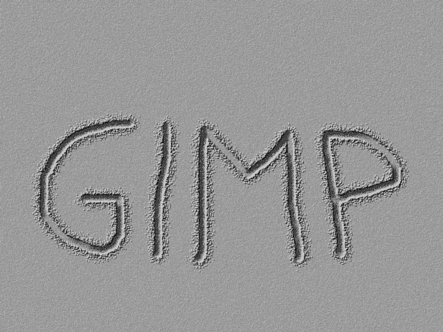

So my previous tutorial on sand writing didnt give it a very good effect and i messed around alot with my technique and found one that makes it look more realistic so here goes! The only script you will need is chisel.
http://registry.gimp.org/node/24217
Step One
Create a new 800x600
fill it with a sand color (ex: c17f27)
Step Two
Add hsv noise with these settings
Step Three
Bump map the layer to itself with these settings
(note: These setting will be used for all bump mapping in this tutorial)
Step Four
Add text with new transparency layer
-i suggest using a paintbrush so it looks like you drew the text in the sand (use Circle 11 with 1.00 scale)
Step Five
Duplicate text layer 3 times, go to Filters>Noise>Spread with the setting listed
Important: Alpha to Selection original text layer. Then swap to the layers that you performed noise spreads to delete the text areas from the layers. Your top 3 layers should look similar to this.
Step Six
Bump map each spreaded layer in order of smallest to largest pixels (10px first then 20px then 30px)
(use previous bump map settings)
Step Seven
Chisel the original text layer
Put the bevel layer to at 60% opacity, and merge it down to the original text layer
Filters>Noise>Spread and spread it by 10px
Step Eight
Bump map the sand layer with the chisel layer
(MAKE SURE YOU UNCHECK INVERT)
Now you are done!

This is my result (the only thing I did differently was put my text layer on subtract mode to give my writing more depth):
This is an actual picture of me writing GIMP in the sand at Long Beach, WA:

After you alpha to selection the text layer, it highlights the text, then you swap to the layers that you performed noise spreads to delete the text areas from the layers, leaving behind the spread outside the text. Make sense?

You don't want to invert your selected text, that would remove the spread. The spread is what you want to keep. The 3 copies of your text layer were suppose to be spread at 10, 20, and 30% as his layer diagram shows. The original text layer remained untouched. When you reselect the original text layer and use alpha to selection, all it does is places marching ants around the text. Then you switch to text layer 10%, delete, text layer 20%, delete, text layer 30%, delete. Now the text layers with spread have a hollowed (blank area) where the text formally was. This is to give the impression of the sand being pressed in with your finger, etc.

This is mine with a value mode setting - nice tutorial adding the chisel layer works real well. :)
Akky make sure you select the background layer when you select map/bump map.
Then select each text (spread) layer as well as the chisel layer from the drop down list.
Un-select invert when you run the chisel layer through bump map.
 Post subject: Re: Writing in the Sand [Updated]
PostPosted: Wed Jun 15, 2011 10:43 pm  (#20)
Rod: She's stuck at the point where she needs to delete the text area from her spread layers. She's says it's not working for her.
Akky, I opened your xcf (your text layer was highlighted and the text selected) and all I did then was switch to the 10%, 20%, and 30% spread layers, and pressed the delete key on each individual layer. Not sure what serves as the delete key with a Mac. On PC keyboards the delete key is DEL.
