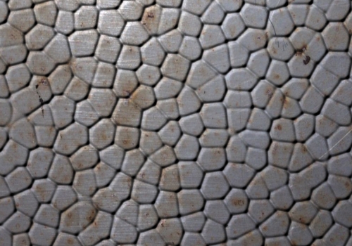

You will also need this metal image available for download at CG Textures.com.
Here is the link to the image on their site:
http://www.cgtextures.com/texview.php?i ... cjh055d732

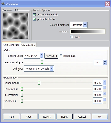

If you don’t already have it, download the Voronoi script from the link above and install it in your Gimp “user” scripts folder and refresh your scripts. Go to Filters>Render>
Pattern>Voronoi and enter the following settings in the first tab of the dialog called Grid Generator. Set the cell size to 50 and the Cell type to Hexagon (horizontal)

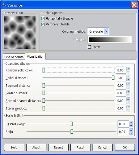

Now go to the second tab, Visualization, and set the Radial distance all the way up to 1. Make sure you check both boxes at the top of the dialog to make your image tillable.
When the filter is finished rendering the pattern, it should look something like this.

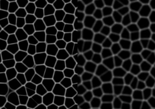

Select the Bump pattern layer to make it active, and duplicate this layer one time. Go to Filters>G’MIC>Contours>Laplacian and enter the settings in the screenshot below, and click OK.
You should get a sort of white looking mosaic pattern like in the image window of the tool dialog above. Go to Colors>Invert to reverse the colors in the pattern. Next, go to Filters>Blur>Gaussian blur and use 10 for both settings. After inverting and blurring processes are completed, set the layer mode to Overlay and turn off the visibility of this layer and just for clarity, name this layer Laplaician.
Here’s what it looks like inverted and then blurred.
Step 5.
Let’s go back to our Bump pattern layer and select it to make it active, then go to Colors>
Invert to reverse the colors. We need to blur this layer as well so go to Filters>Blur>
Gaussian Blur, and this time set both values to 15 and then click OK. Here’s what your Bump pattern layer should look like now.

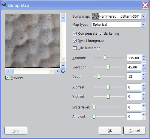

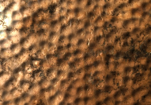

OK, time to work some magic. Turn off the visibility of the Bump pattern layer and select the Metal layer to make it active. Now go to Filters>Map>Bump Map and make sure you have the Bump pattern layer selected in the drop down at the top of the Bump Map dialog. You should make a habit of always checking this when using the Bump Map filter. Set the map type to Spherical, check the two boxes Compensate for darkening (should already be checked) and Invert bumpmap. Set the Depth to 12 and click OK.
Our image is now starting to take on that hammered look that we want.
Step 7.
Turn on the visibility of the Laplacian layer and either leave it like it is, or lower the Opacity to 50% or whatever you prefer.
