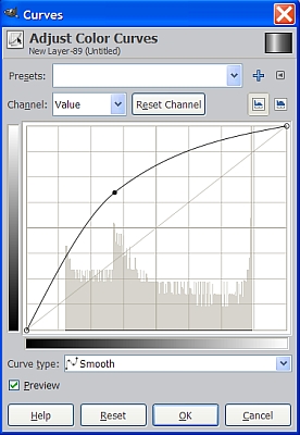

Our gradient is still too dark, so go to Colors>Curves and move your curve up somewhere between one to two squares from the middle, in the curves dialog, and click OK. Different gradients will require different curve adjustments. I used this one.
Here’s what the gradient looks like after the curve adjustment.

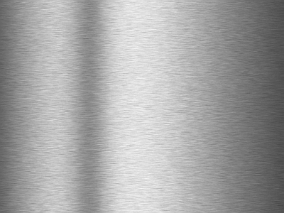

Duplicate the Gradient layer and create a brushed metal texture on the duplicated layer using RGB Noise and Motion Blur like we did in Metal Wurx - Part I, and name it Brushed Metal. If you don’t already know how to make brushed metal, go back and review my tutorial for brushed metal here: http://www.gimpchat.com/viewtopic.php?f=23&t=3750
We now have a nice custom metallic gradient, and we can see what it looks like used with a simple brushed metal texture layer.

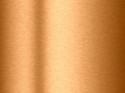

Change the layer mode of the Copper layer to Grain Merge and take a look at the results.
The color is quite a bit richer.

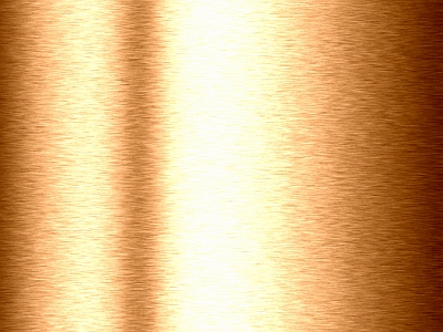

Now look at each metal color layer, one at a time, by turning the visibility on for the selected layer, turning the others off and changing the layer mode. Just for grins, you might also try duplicating the Brushed Metal layer and placing it at the top of the layer stack, changing the layer Mode to Grain Merge for a more intense effect.
Just play around with layer Modes and Opacities to get all kinds of results

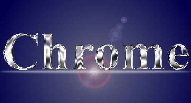

Well, we just created 8 different metallic finishes, with numerous variations. Make sure you save the list of metallic colors because they will be used in future tutorials. Here are some metal sample finishes using a conical setting for a gradient overlay to the brushed metal and a metallic colored layer with various layer modes.
These colors can be applied to any type metal whether it is brushed, hammered, pitted, smooth or shaped, bumped and a curve applied for making highly reflective surfaces like chrome. Have fun experimenting!
I hope you enjoyed this tutorial. Metal Wurx – Part XIII will explore several different methods for creating awesome chrome effects. I have included a ton of resources as well as links to several other great tutorials by others using even more methods for making chrome and other metals. You won’t want to miss this one!
