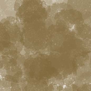

I found this script a little difficult to use at first so I thought a tutorial would be useful.
1. Create your brush on a square background. H and V dimensions must be equal for the script to run.
2. If you want to be able to choose colour, ensure your image mode is set to Grayscale and the image is flattened.
3. Run the script.
4. Save the resulting image as (name).GIH
5. Choose your preferences as below. I chose 20 rotations so this is how I filled in my preferences.
This shows four random rotations that the brush gives.
With colour, jitter and reduced opacity.
Feel free to download my brush if you have a use for it.
