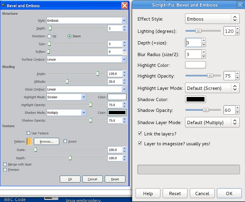

I am on step 21 of this tutorial. I have had a problem with this before. My Bevel and Emboss is Script-Fu and the one in this tutorial is under layers. I don't have that one or do I know where to get it. But I tried to fudge it but I just can't get it to come out right. I want it to have that etched look the way it is in the tutorial but with my bevel and emboss I cant get it to do that. Mine raises the arrow up and in the tute the arrows look like they are indented.
Does anyone know where I can get the other script or help me figure out a solution to this one.
Mine is the Script-Fu one on the right. Thanks in advance :oops:
This is how mine came out on the right, notice it doesn't have that bevel around the arrow. I matched it up as best as I could but it doesn't have the up and down feature.
 Post subject: Re: How to Make 3D Push Buttons - Metal Wurx XVIII
PostPosted: Wed Jun 06, 2012 5:04 pm  (#18)
It's in layer effects. I thought you had that. You should be able to find it by right clicking on the layer. Do you not have the PY version?
PostPosted: Wed Jun 06, 2012 5:17 pm  (#19)
I have the layer effects and they are under script-fu. I have had the same ones forever. But, the one Drac has is different. His is under Layers and it is just called layer effects, mine is called Script-fu Layer effects, I can't get the same bevel with mine as it shows on the two screen shots.
PostPosted: Wed Jun 06, 2012 5:19 pm  (#20)
Try downloading the python version - it's much better than the script-fu version.
