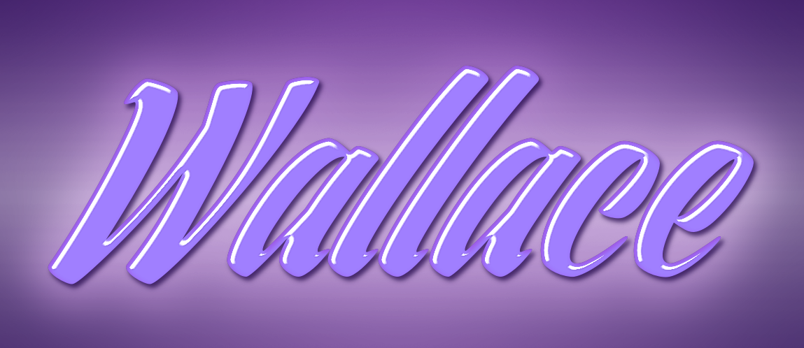

Here's my text... ;-)
BTW... I didn't apply the 'alpha curve' to the highlights and seeing it in full resolution I can see that I should have.

excellent Wallace !
and a whole lot of purple shades ! nice !
maybe that CRogers guy was right and the inner shadow actually needs to be the other way round....
i wasnt sure when i looked at my result....but it was like that in the script and it looked right, so i did it just the same

Esper wrote:
excellent Wallace !
Thanks Esper, now that you mention it, maybe shifting the shadow in the opposite direction could make a difference. :puzzled

Esper wrote:
dunno, this certainly does not look right, does it ?
or this
I think your right, It looks better the original way you explained it in the tut.

At some point I wondered if removing the selection or not. Also in what position the inner shadow layer should stay. But it seems that I dealt with it well.
"i think your inner shadow needs to be less black and more transparent to look like my result"
"you should blur the highlight a bit, then tighten with the alpha curve, so that you get a very thin and crisp highlight"
Yah, it really makes much difference. I do not blurred before applying the curve. Thank you for looking these details!
I'm almost memorizing the steps! Thx for the tuto!
