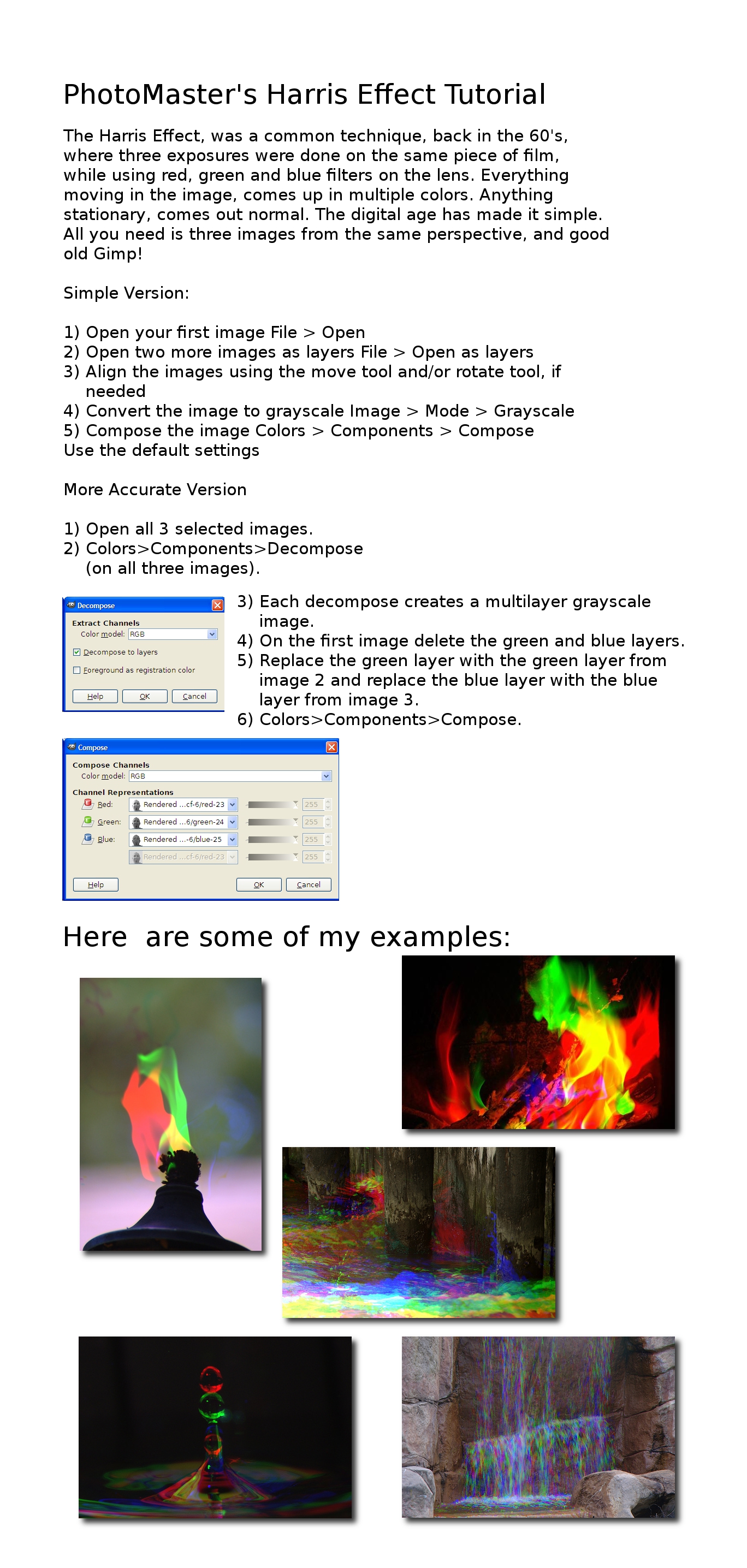

A little bit of art history? Maybe?
Note: The one with the patio torch, was hand held and the layers were aligned prior to composing. The image was cropped afterwards. The rest were all done with a tripod.

2-ton wrote:
ok, how do you replace the layers with the other layers?
I delete a layer from the first image and then drag a layer from another image and drop it on the new image.
