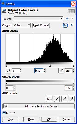

We need to darken our image a bit for our purposes so select the Clouds layer and go to Colors>Levels and set the middle Output value to .50.
Now our image is a little darker and the colors more intense.

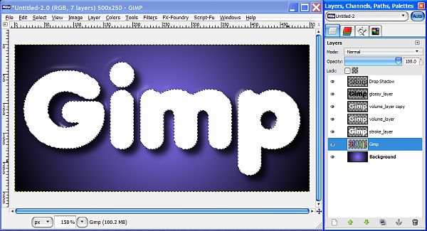

The filter will create two new layers for highlight and shadow. Select the shadow layer and go to Layer>Merge Down, then select the highlight layer and go to Layer>Merge Down.
Step 11.
Right click on the text layer and choose Alpha to Selection. Go to Filters>Light and Shadow>Glossy Stroke 3D and in the filter dialog, click on the color at the top and it will bring up the Color Picker dialog. Set the color to white (FFFFFF) and the Selection to Fill. You have the option for selecting a stroking brush but we’ll just use the default circle brush for our purposes. There are several other settings you can adjust but the only other things we will change is the 3D amount and the Light height. Set the 3D amount to 9 and .2 for the Light height. The light color should already be white by default, if not make it so.
When you have everything set, click OK and the filter will create five new layers for you.

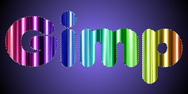

I had all kinds of fun trying different bgs, different layer modes, and finally I just saved one of them.
Thanks for the excellently written tutorial Drac.
Font is Thickhead
http://www.dafont.com/thickhead.font

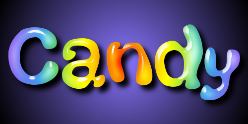

Draconian wrote:
O - That looks excellent. Love the multicolor and the soft gradient-glow effect. Care to share what you did?
I didn't do a whole lot to it. I saved the alpha to selection of my text as a path in case I might need it farther down the line.
I made a new layer above the Background layer (blue-black), and did a radial gradient of my rainbow gradient. Activated the text path, inverted it and deleted on the rainbow radial gradient. That's pretty much it.
This one I did using a red and white radial gradient with the repeat set to Triangular wave.
I've attached my rainbow gradient and the xcf file of my results in a zip file.
