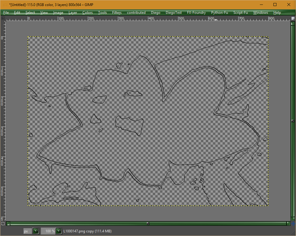

Step two: Run Isophotes:

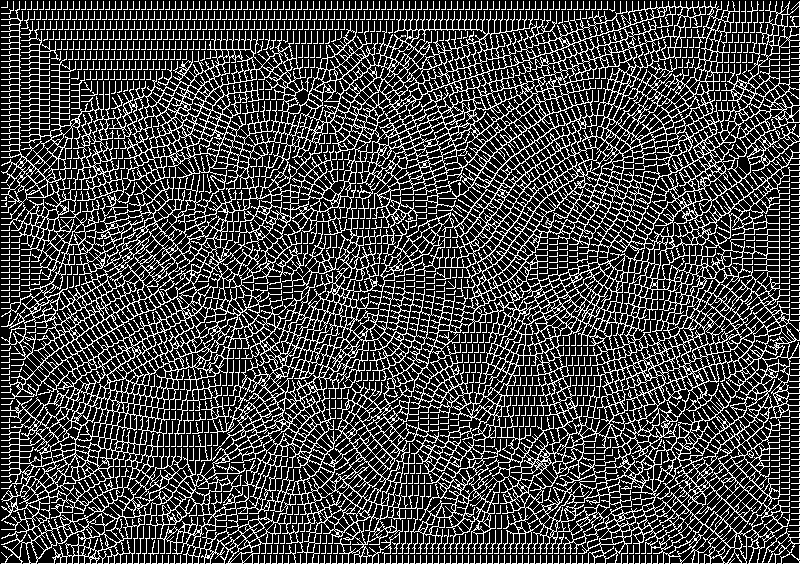

Invert the Skeleton result and merge the Isophotes black to create the mask:

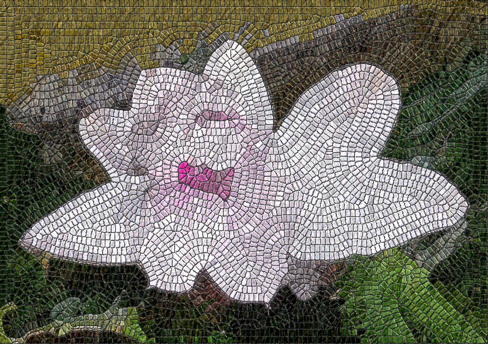

OK; the result (resized and embellished; not going to do a tut on that). :)

maybe (but only maybe) these could be the substeps after having run Isophotes:
- select a transp pixel on the outcome (to get the shapes otherwise RobA script takes the contours of the image to start drawing paths)
- run RobA script with defaults (paths are created according to the shapes)
- invert selection (to have the Isophotes drawing lines selected)
- cut (to remove the isophotes drawing lines)
- select all
- stroke the path with solid colour 1 px and line type "sparse dots"
- fill with White everything except the dots (either of these two ways: add a White layer below and merge down the dots layer, or select again the transparent pixels and fill with White)
- delete the path
- threshold the dots
- run Skeleton
- (at least in my case) run Repair Inpaint Holes (I had a pixel inside each Tile)
I got something which looks like a base to continue
