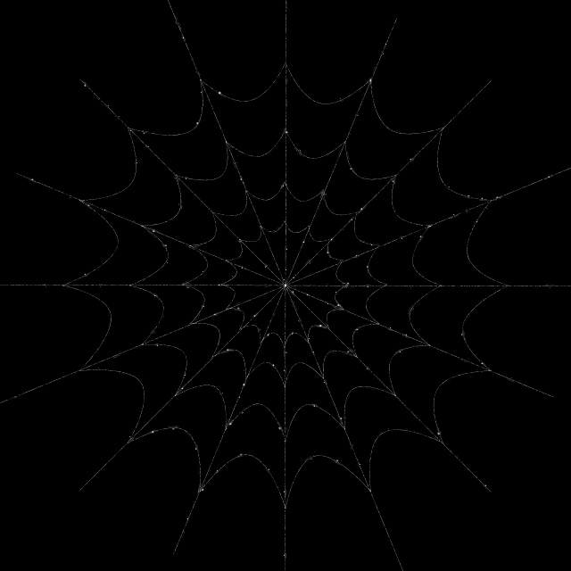

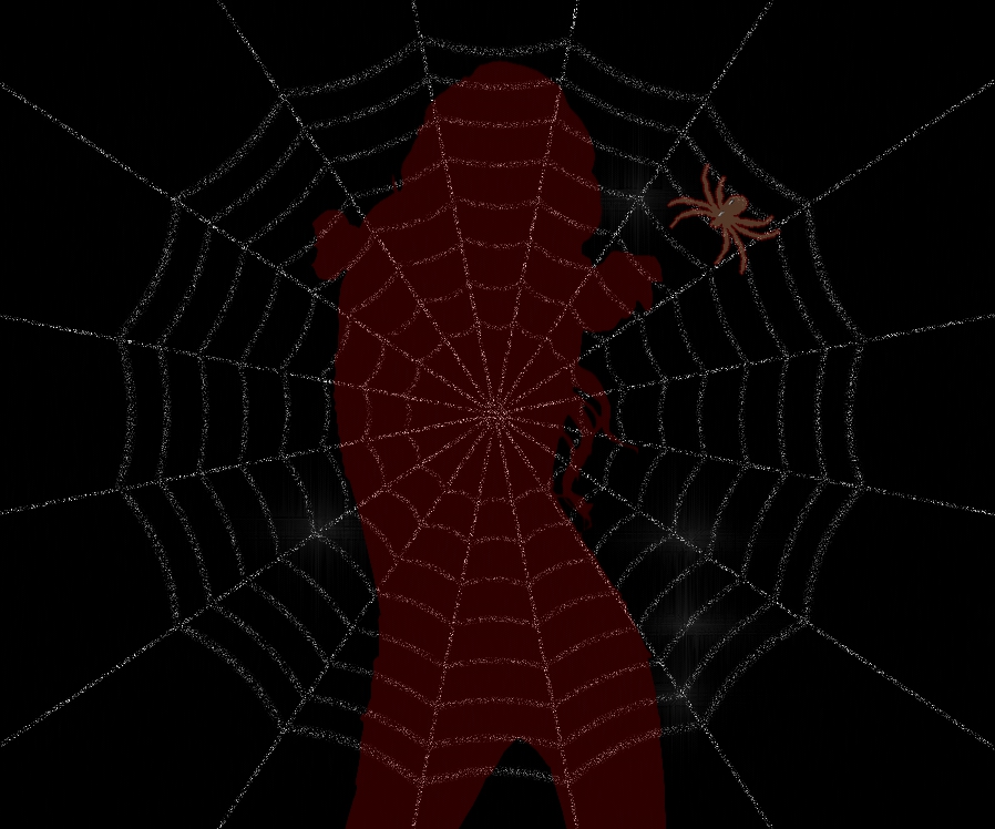

I need to figure what you did when I am more awake. That is sweet! Here's mine. (not nearly as nice)

@Lyle: I only curved one flower spike path, duplicated that path 3 or 4 times, scaled each flower spike path (just set mode to path on scale tool properties) larger than the first. No further bending necessary. Ratio remains the same throughout, so they always line up with the nova strands.

edit; found it. Never even noticed the paths option in the scales dialogue before. Learn something new every day. lol
