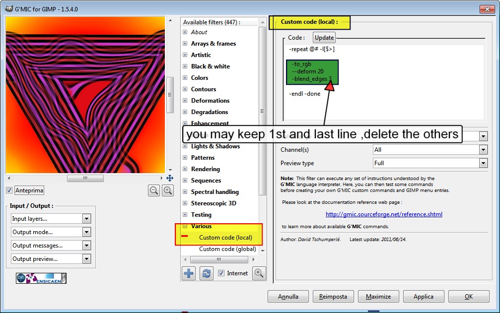

NOTE that are the command given with a filter "Graphic Novel" BUT would be a bit complex "remap" them to the graphic interface of Graphic Novel ,i.e assign the right value to the right slider , ..it may be done but there is quicker alternative :
is GMIC> Various> Local code
[img]http://www.gimpchat.com/files/158_Screenshot%20-%202_18_2013%20,%203_57_18%20AM.jpg
now the first and last line may be kept :
to simplify that 2 lines , the 1st and the last are to take care of selection , transparency and of multiple input/output , are not always needed but no need to remove them in the other cases..so you may just keep both
,in the middle instead should go the real command
so just replace what in the middle with the desired command, in our example just paste
-gimp_graphic_novelfxl 0,2,6,5,20,0,0.699301,6.99301,0,1,0.727273,0.804196,1.32867,0,1,6,0.314685,1,1,0.447552,0.881119,0.699301
there and hit apply or ok
If you think to reuse you may "fav" as for any other filter
