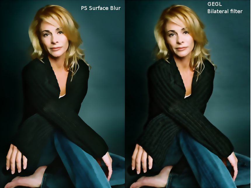

I'm looking for the way that PS Surface blur works and I found that works with two parameters: radius and threshold.
GEGL bilateral filter works, also, with two parameters: blur radius and edge preservation.
I've done the the following comparison with the same values ​​for these parameters:
