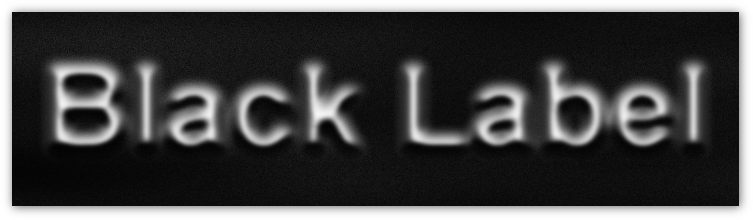

Did some labels from my dymo machine
this one is without cloud or grain layers

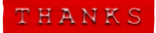

Great job everyone...love the gimp tools one.
Had to do one more. I don't recommend using yellow for BG, but too lazy to change it.

Nice work everyone, Molly suprisingly black works pretty well...
