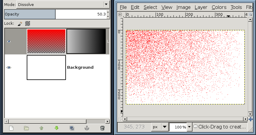

In "dissolve" mode, Gimp takes a pixel at random on either layer, with a probability to take the pixel from the top layer equal to the opacity of that layer.
Thank you for mentioning that. I just took another zoomed in look at Dissolve mode. What looks like a pixel chosen from the lower layer is actually a transparent pixel in the upper layer. It's easier to notice if you hide all lower layers or have only one layer. The lower the opacity, the more transparent pixels you get.
I guess what you're saying is that the percentage of non-transparent pixels is the opacity percentage?
More specifically, the probability is equal to the opacity of the pixel after the pixel's original opacity, the layer's opacity setting, and the layermask have all been applied.

saulgoode wrote:
Cool example! Mind if I steal that?
Of course I don't mind.

saulgoode wrote:
The attachment SSdissolve.png is no longer available
Indeed...
