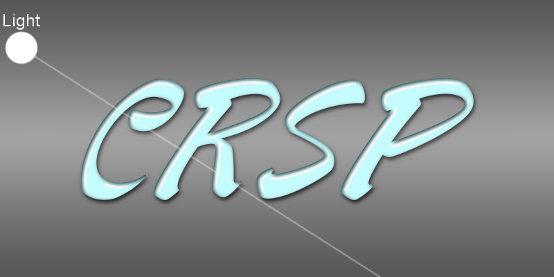

PostPosted: Thu Aug 15, 2013 6:19 pm  (#13)
CRogers wrote:
*snip*light source*snip*
im not sure if i get you....(english is not my first language so this discussion may be a bit complicated for me)
are we talking about the text from my tutorial or the "glass" effect i did later ?
on the tutorial text we used an Azimuth of 135 when bumpmapping, so the direction of light is known
thats why the highlight is on the left side and the shadow on the right
what is not exactly clear is why the inner shadow on the left looks correct
shouldnt that side be illuminated as well ?

Esper wrote:
Ah, maybe the mistake is mine! I thought you were talking about the outer shadow. But that depends on whether or not the text is supposed to be clear glass or not. I'll post some examples after I can get to a proper computer. Sorry for the confusion. I will include an example of caustics in the sample as well so.you can see what I'm talking about there.
well maybe not, i posted two quick variations after Wallace posted his result, and one of them had the dropshadow the wrong direction
anyway, looking forward to your examples regarding caustics

At some point I wondered if removing the selection or not. Also in what position the inner shadow layer should stay. But it seems that I dealt with it well.
"i think your inner shadow needs to be less black and more transparent to look like my result"
"you should blur the highlight a bit, then tighten with the alpha curve, so that you get a very thin and crisp highlight"
Yah, it really makes much difference. I do not blurred before applying the curve. Thank you for looking these details!
I'm almost memorizing the steps! Thx for the tuto!
bbbbbbbbbbbImage
