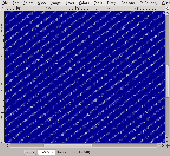

  • "Filter/Noise/Spread noise" with a spread of 1 or 2 px:
