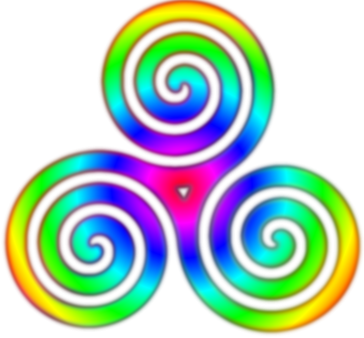

you are dangerous with your Simple filter link, i never try before because they look too simple but you are right there really cool..just too additive :hoh
Anyway you will remember my "rainbow" triple spiral download/file.php?id=446 well this is what that filter did
and tile so well
So back in theme i ended with a sort of sphere..hem..a very squared sort of half sphere since is semitransparent is easy see has no a backside but...
