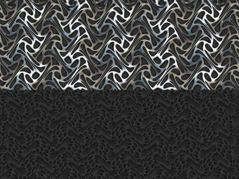

Here's a script that will create this texture (default settings) and many more:
I've always loved this effect, but could never accomplish it until today. Here's the tutorial it's based on: http://www.tutorialwiz.com/metallic_background/
Here's the code for the script. Copy and paste the code into your favorite text editor and save it with a ".scm" extension. Save it here: C:\Program Files\GIMP-2.0\share\gimp\2.0\scripts and refresh your scripts. It can be found under Filters > Render > Ripple Texture...

Open up the desired image size. Although the tutorial uses a checkerboard, I happen to like solid noise.
Filters > Render > Clouds > Solid Noise
Run the script
Here's a colorized version (Colors > Colorize)
Experiment with different settings and see what you can come up with!
Cheers!
Art

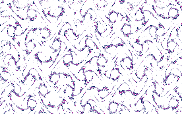

I had a play with a hex filled pattern layer then a color balance edit. Default script settings by the way. :)

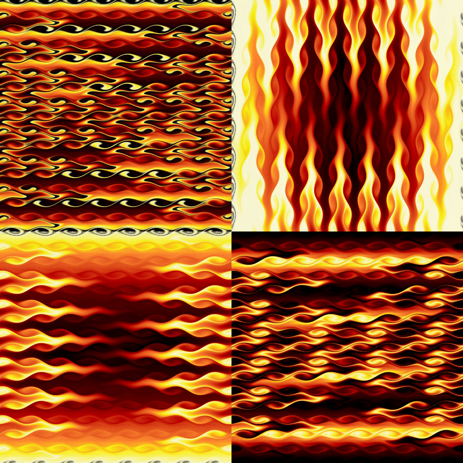

Running patterns through the filter results in some really cool stuff. :)
