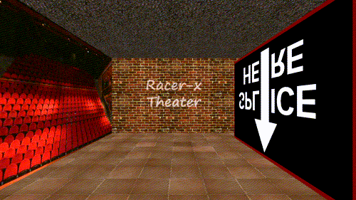

Pretty good, considering you went the very long way to do this.
I would've done something like this in Aviutl (free) in about 10 minutes total time. Here's an interesting animation I did when I first started learning Aviutl:
I had to decimate the frames to lower file size, so it's not as smooth as it really is in full 1080p resolution.

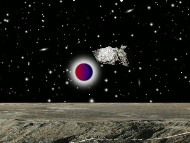

Tas_mania wrote:
Thanks for the thumbs-up TimeLord and PhotoMaster.
Hi racer-x. Panning across the screen in that clip is very good. Running an animation in front of another animation
is a different process.
http://gimpchat.com/viewtopic.php?f=25&t=15700&p=217388&hilit=Steve+animation+merge#p217388
It maybe harder to have the planet in Steve's animation pass in front of the asteroid :)
I would like to do a comparison of the animation merge scripts.
It took less than 2 minutes to create this second version with the planet in front
In the original gif the three .xcf files were opened in the order of asteroid, planet and background, in this second version the order was changed to planet, asteroid then background.

Steve I was using the shuffle and merge script today and wanted to ask if the 2nd and 3rd animations have to be smaller than the background animation?
I have adopted a technique where the the merged animations share the same canvas size as the background, except
they have an alpha channel switched on. That way you know exactly where they will appear in the finished 'canvas'.

Tas_mania wrote:
Thanks OMG and RJKD.
Same size is best, as you say, you know exactly where they will appear in the finished 'canvas'. I used smaller image sizes in my example to keep the file size down, it worked in my example because I wanted the planet and asteroid in the centre, which is where they are positioned if they are smaller than the canvas
