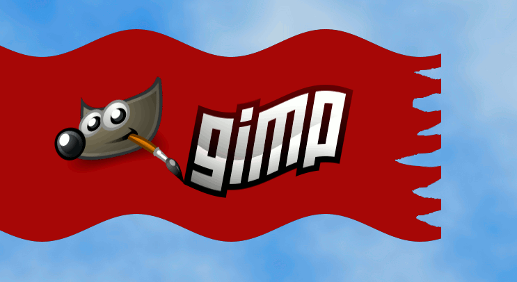

5) Make link to MathMap
cd ~/.gimp-2.8/plug-ins/; ln -s /usr/bin/mathmap
Anyway it works now, Thanks! Some things don't seem to do anything and some work well. The flag animation is simple and works well.

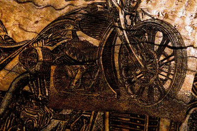

A couple of more tests. Just quick tests, didn't weed out bad frame alignment.

Hi racer-x. Nice animations, especially the droste effect gif.
I experimented with going backwards when I reached the lowest level of droste and then going back to the top.
Surprising it didn't look as good as I thought it would. 2 changes instead of one could be the reason.

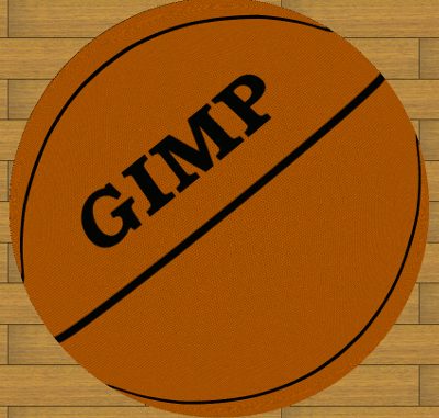

That animation you linked to is cool, no way you can do that in mathmap. Mathmap is fine for a photo editor plugin, but lacks many options to make a good animation creator. It's fine for simple animations like this however....
