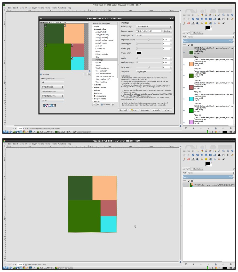

Can you check the code output to the layers tab? It replicates whatever is currently in the Custom layout line even when using presets.
For example using 9 layers, Reset | Horizontal array | Angle: 12.
The image result is as expected.
Output code to layer: Preset # + Reset code + angle.
[G'MIC] Montage : -gimp_montage 3,"V(H(0,1),H(2,V(3,4))",1,0.5,0,0,0,0,0,255,12,0,0,0
The image result does not seem to match the code output.
Also, It could be my eyes and it works fine, but isn't the reset code missing a bracket? :blind

Odin : which version of G'MIC do you use ? Is it the latest. You're the first that report this kind of issue :)
The brackets in the Custom Layout code are in fact useless and can be omitted :)
I've put them to make the explanations easier and things more clear for the video tutorial.
This is what I get with 9 layers and Default Custom Layout code.

G'MIC 1.5.9.0, Gimp 2.8.10, Linux.
I was referring to (after you use Montage), the code output to Gimp Layers dialog does not include the preset formula.
For example, with Custom layout empty using Horizontal array preset.
[G'MIC] Montage : -gimp_montage 3,"",1,0.5,0,0,0,0,0,255,0,0,0,0
I was expecting the preset formula rather than empty quotes. Only custom code or (when using presets) whatever is still in Custom layout (even a random string) is sent to the Layers dialog.
Also, the 'example code' in Custom layout looks to me like it is missing a bracket and might confuse people about code structure.
Current example code: V(H(0,1),H(2,V(3,4))
with missing bracket: V(H(0,1),H(2,V(3,4)))
 Post subject: Re: New G'MIC filter : 'Arrays & tiles / Montage'
PostPosted: Fri May 16, 2014 3:32 pm  (#53)
Joined: Jan 03, 2011
Posts: 1656
I see. The layer name contains indeed the exact G'MIC command to call to get exactly the same result as the filter you've applied.
If you choose a montage type that is different than "Custom Layout", then yes, you can put anything you want in the string (which still remains a parameter of the command,
but which is in fact ignored, as the first parameter tells to do it).
Also, I will add the missing bracket in the next filter updates, thanks for noticing it.
