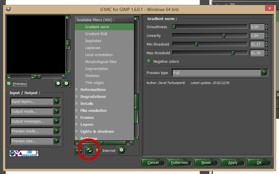

I first added GMIC to gimp at least over a year or 2 ago, and I'm thinking I should probably update it. What's the best way for me to do this?

Major releases have to be manually updated unfortunately. Once you copy the latest gmic plugin into your plugins folder, you then can update the presets using the update button. :)
