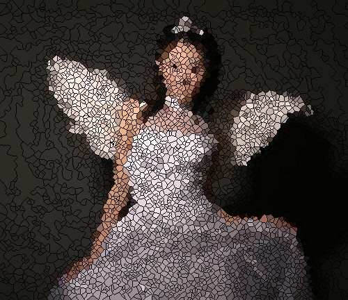

just to understand what we are talking about:
mosaic by G'MIC mosaic (currently available)

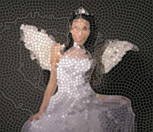

opus-vermiculatum
opus-musivum
