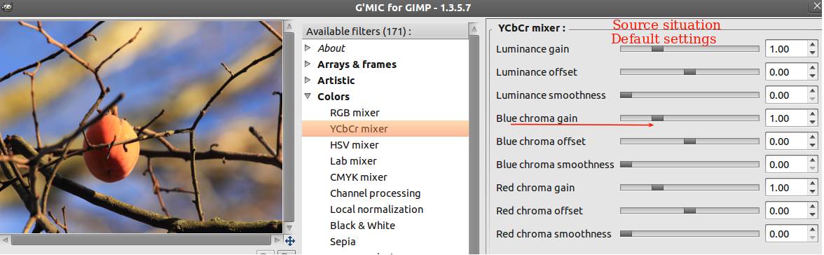

Hi all.
I would like to ask you to help me.
I'm trying to to understand with the work of MixerYCbCr in G'MIC-plug-in.
I want to understand the algorithm of this effect.
But I do not understand how it works.
I'm not sure about my knowledge of the work of this effect. But I read how it should work in other programs.
For example in Edius (videoeditor for windows):
U and V are similar but you control the balance between two primaries and their complementary color. U and V have same abscissa value range on the X axis while they differ for the Y axis:
With U (Cb), the higher value you are, the more you're on the blue primary color. If you go to the low values then you're on blue complementary color, i.e. yellow.
With V (Cr), this is the same principle but with Red and Cyan.
If you push U full blue and V full red, you get magenta. If you push U full yellow and V full Cyan then you get green
In practice, I move the sliders Blue chroma gain and Red chroma gain and this mixer gives me a completely different color than I expected.
For example I move the slider Blue chroma gain to the in the leftmost position and look forward to gain yellows,
but blue sky turns green and yellow colors - purple ..
I move B chroma gain and R chroma gain to the in the leftmost position, but I get black-white image..
I do not understand why ..
Explain, please.

Basically, the control 'contrast' multiplies the value (in Y, Cb or Cr) and the control 'brightness' add an offset to the value.
So if you add 'brightness' to the Cb component, your image looks more blue.
If you remove brightness to the Cb component, your image looks more yellow (the complement color to the blue).

I've already explained it: the 'contrast' parameter is a multiplying factor you apply on your channel values (Y,Cb or Cr), while the 'brightness' parameter is a number you add to your channel values.

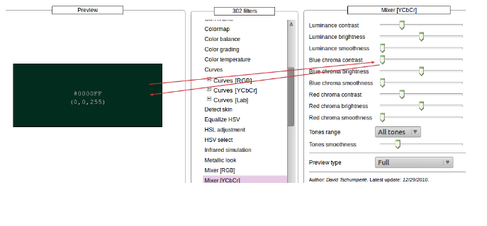

I load a picture in blue - absolutely pure blue 0, 0, 255.
I move the sliders Blue chroma contrast or Blue chroma brightness and
get a green color.
But why green color ? From absolutely pure blue .. ?
The same situation with absolutely pure red
Explain, please.

My answer to myself - Just look attentively at picture
https://en.wikipedia.org/wiki/File:YUV_UV_plane.svg
