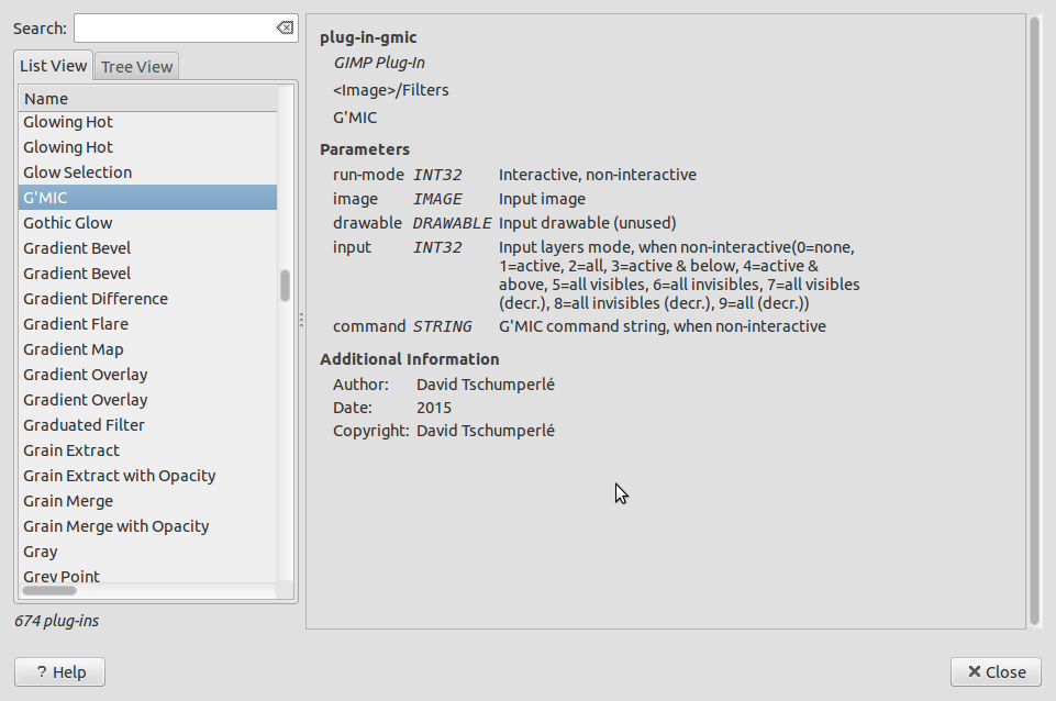

Dinasset, it should be already the case.
In the screenshot below you can see you can choose the input type:
You cannot create a new image, but you can create a new layer (or a new set of layers),
just by enclosing your G'MIC command inside a '--local ... -endlocal' block.

thanks David, I will use the available features
my fault I didn't understand the meaning of the "1" (confused, sorry!)
