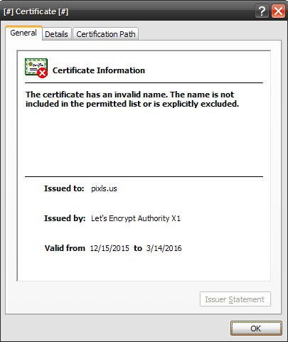

I've had some interactions with Pat David but still get the following (and cannot subsequently access the site). I've checked and even tried to do some things to bypass, but to no avail. I can use Edge to access the site, but rather stick with using my Sandbox (XP VM). :)
Site (where G'MIC is discussed): https://discuss.pixls.us

Attached the cert issues. All prime and sub certs are fine. Only one that's giving me a head-ache is the one in-between (Let's Encrypt Authority). Very strange. I tried clearing all my certs and everything (originally just the cookies and certs) per my conversations with Pat but to no avail. Weird. I am using Iron Browser and it may indeed be an issue with Iron since Chrome is working fine (based on your input). :)

Below's the cert itself (other tabs say things are hunky dory). :)

So I looked into this based in problems another iron browser user was having on winxp...
https://plus.google.com/+PatrickDavid/p ... 1&hl=en-US
Long story short, Windows XP is past End-of-Life, so the crypto API's are woefully out of date. (Cannot handle SHA256 signed certs, doesn't support SNI, and has problems with certs that have namespace restrictions).
I'm glad (though a little surprised) that at least you found a browser that you can use as a workaround - though honestly why not sandbox with a modern Linux instead of XP?
I'm also sorry for the problems. I have to make a decision between weakening security to accommodate an old OS, or drop support for it to support stronger security. :(

XP is my crutch and I like running multiple Sandboxie sessions within my XP VM (double-sandboxed for each session). There is no Sandboxie equivalent for Ubuntu which would mean I would have to delete my VMs (recover from gold point) more often and I don't like to do that (try to keep my VMs for a week or two before I do the golden recovery point flow). So it now appears to be an XP issue with crypto-hashing, aye? Would be cool if someone would come up with a patch for XP users, but I know XP's life is limiting to say the least. lol
