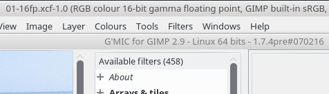

 Post subject: Re: G'MIC plug-in for GIMP now manage high-bit depth
PostPosted: Sat Jul 02, 2016 10:56 am  (#8)
Posts: 2613
Got it, thanks. 1.7.4pre070216

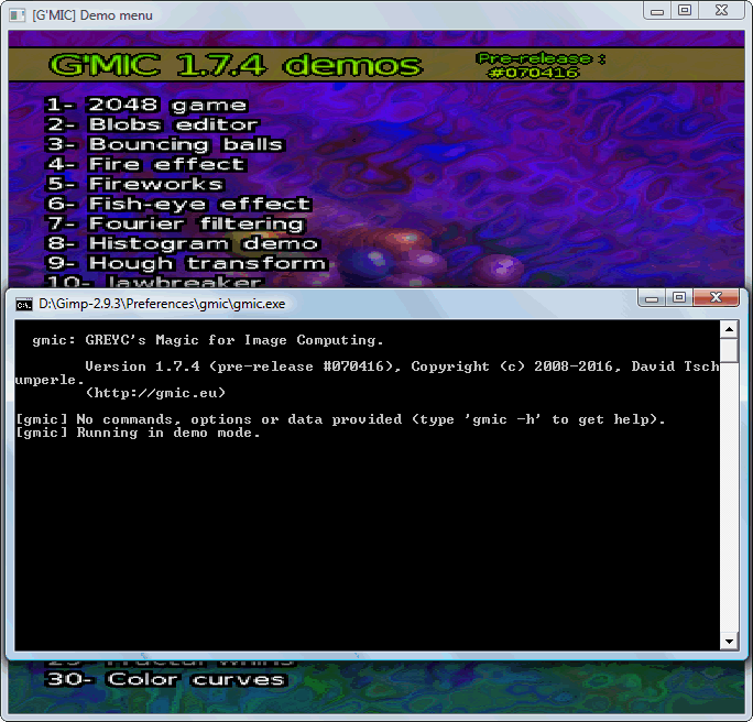

PostPosted: Mon Jul 04, 2016 12:05 pm  (#10)
Also for Vista 32bit - compilation 1.7.4 without problems.
Thanks David.
