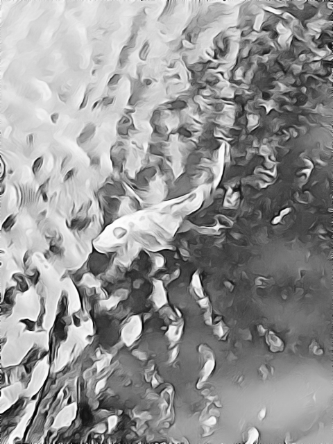

G'Mic Inkwash
Great results with low resolution however unable to get similar results on larger images.
I need to use large images for printing on large paper and can't get acceptable results. Does anyone here have experience with the control sliders for Inkwash on large images?
File comment: 640 480 / 4000 3000

It will do it's thing for the larger image. But if you want the same results for a larger image as smaller you may have to change the settings to match otherwise you may not even see any effects at all.
I used the same size image here and cropped it to about 2900 square
First one I did with default settings and the second one I did with double settings and with manual settings
