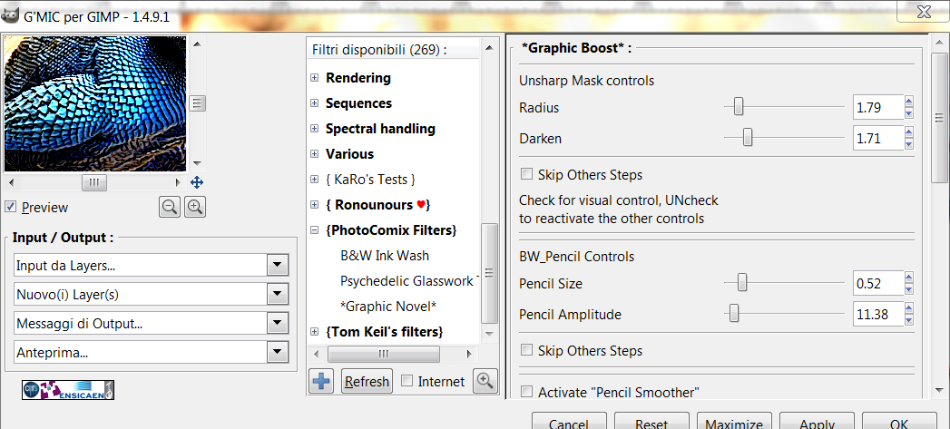

Oregonian wrote:
Does this update in G'MIC? How do I know if I have the old one or the new one? I updated and I see it listed in Faves and also in Artistic but not in PhotoComix.
Short answer:
if you enabled my source in About/additional filters that mean here
then the filter will show up in the "PhotoComix" submenu close to the bottom of filter list so here
But not yet, i got lost by testing images (and more browsing and downloading image to test )
well i may upload in a few minutes
as i said new one will be in the PhotoComix submenu, and anyway will be *Graphic Boost* instead then Graphic Boost
