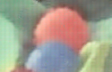

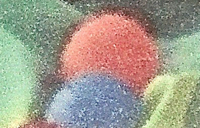

Look at these 3 examples of outcomes (source is a noisy image on Google)
block-pca with default parms
block-pca with parameters values almost doubled
anisotropic with default values
up to you to judge (IMO anisotropic, even w/o tuning, is much better, but that's my opinion)
