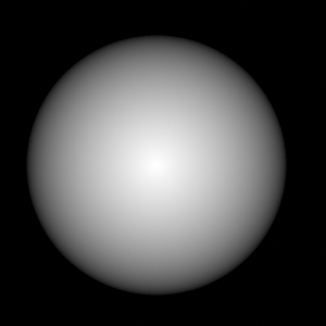

I actually want to have G'MIC calculate the pixel values for a heightmap representing, say, a perfect hemisphere.

Here's a heightmap that does not correspond to a half-a-sphere when read/redd into a Computer-aided machining/CAM program; it looks like it "might/could" be one, but mathematically it's not. It's just "eye-balled."
G'MIC, I believe, is capable of producing one that perfectly corresponds to a hemisphere. (And in a height map, the top half of a sphere hides the bottom half, so only need the top.)

Try this for a mathematically correct hemisphere:
X=x-w/2;Y=y-h/2;R=sqrt(X^2+Y^2);Z=sqrt((w/2)^2-X^2-Y^2);if(R<w/2,Z,0)
and see what I mean. (Yes, G'MIC can compute heightmaps!)

The solution was beyond the contributors here. It does produce what you wanted. The RGBA Normalisation seems to show thats it's pretty much perfect.
