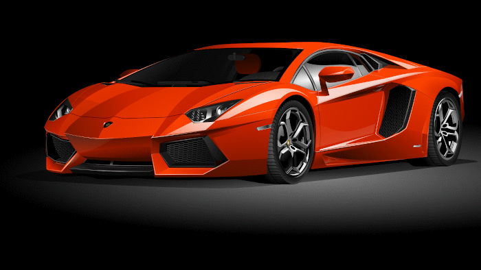

I'm getting the same results here using G'mic 2.8.0, I don't think it's much to worry about though. Just round it off to the nearest tenth.
I just found out this makes an interesting effect when you play with blending modes.
