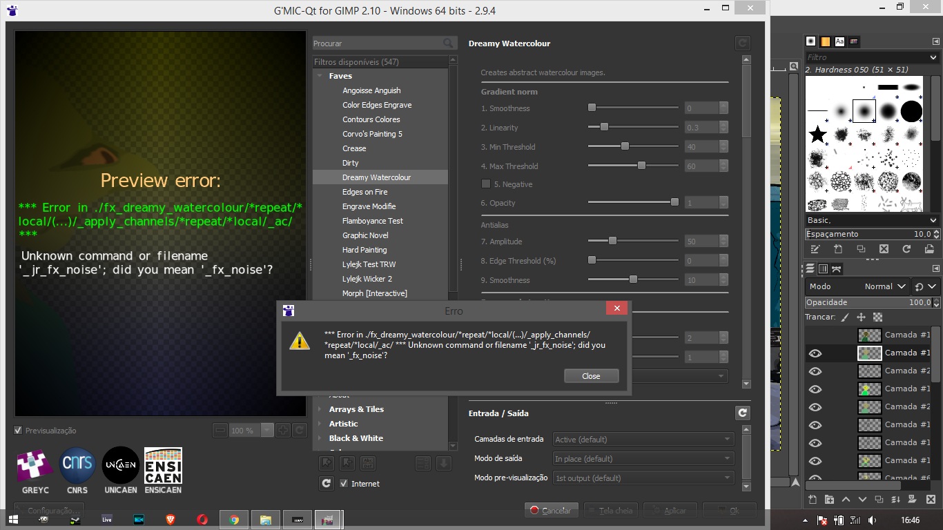

I'm using Gimp since June and everything was working fine. I was experimenting with all the G'MIC filters and everything was working fine. But this week some filters started to give errors. The filter I was most interested in was "Dreamy Watercolour" but unfortunately, it doesn't work anymore. I'm not sure what I did for this to happen. I did a search to see if someone had this issue but found nothing. Has this happened to anyone else? With these specific missing commands\files?
I use Windows 8.1, GIMP 2.10.22, G'MIC 2.9.4
The error I get in the preview is:
PREVIEW ERROR
*** Error in ./fx_dreamy_watercolour/*repeat/*local/(...)
/_apply_channels/*repeat/*local/_ac/ ***
Unknown command or filename '_jr_fx_noise'; did you
mean '_fx_noise'?
I attach a JPG screenshot.
If someone could give me some clues to solve this issue I would be very grateful. :yes

Just checked: I confirm, same error on Windows 10, Gimp 2.10.23, G'mic 2.9.3

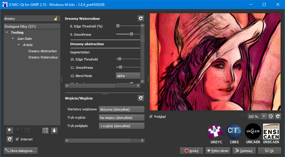

Immediate solution:
It works in version 2.8.4 (because it doesn't update anymore - so the file is attached).
Download: https://gmic.eu/files/windows/
