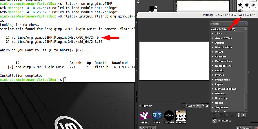

Using a flatpak installation and I have just done a clean install, you need to install a flatpak gimp_gmic_qt not a zip or a debian package. There is one snag, two versions to choose from and the 2-40 version works here.
If you run a flatpak list it should show what you have.

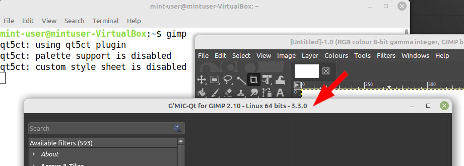

This is a regular Gimp 2.10.34 using that PPA and gimp_gmic_qt from a zip file. Version 3.3.0 - I still have updated it. Not much in the way of messages running from a terminal.

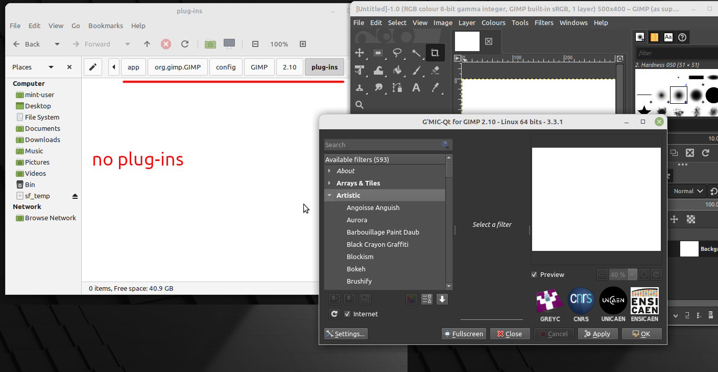

This is the flatpak plugins folder - it is empty - no plugins in it so far. Also the flatpak Gimp and the flatpak gimp_gmic_qt
