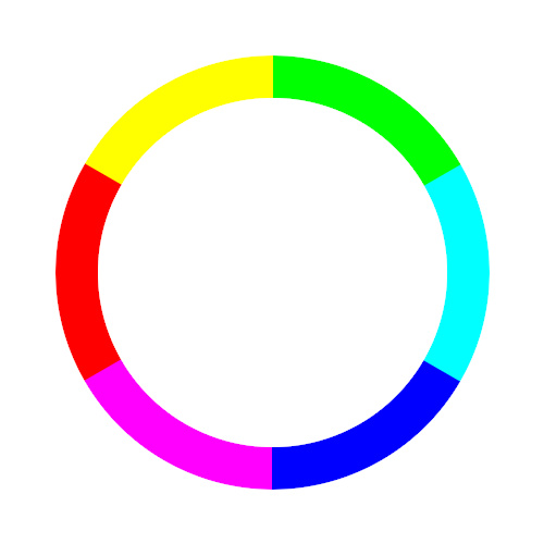

Inspired by this thread, I intend to propose a new G'MIC filter "Color Wheel".
With default parameters, it would give:

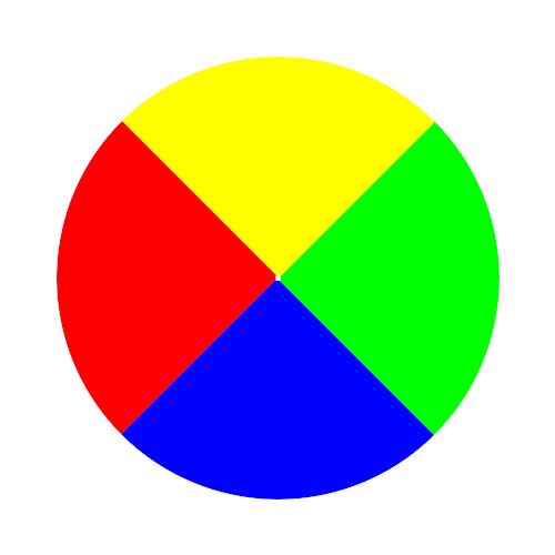

With default parameters except that "Internal Circle Radius Percentage = 1, Type = Opponent Model", it would give:
With default parameters except that "Internal Circle Radius Percentage = 50, Parts = x3, Type = Red-Yellow-Blue Model", it would give:

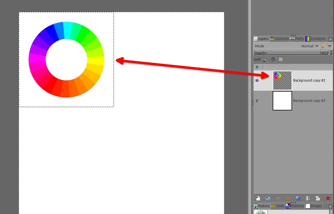

I added this code below on top of your code, as I have some code before in my "~/.gmic" and your wheel was in "Deformations" due to the code above :hehe
#@gui ____<b>Colors</b>
#@gui Color Wheel (prerelease): cl_colorWheel_prerelease, cl_colorWheel_prerelease(0)
#@blablabla....
If I may, the only thing is that the result does not respect the size of the canvas, that would be a plus+ if the result would be on a layer of the canvas size (G'MIC 3.3.5 / GIMP 2.10.36 ), anyway it's very nice, thank you :tyspin
EDIT: forget what I said about the canvas size, I moved the External Circle Radius slider... and result get bigger :bigthup (sorry, I was asleep :oops: )
