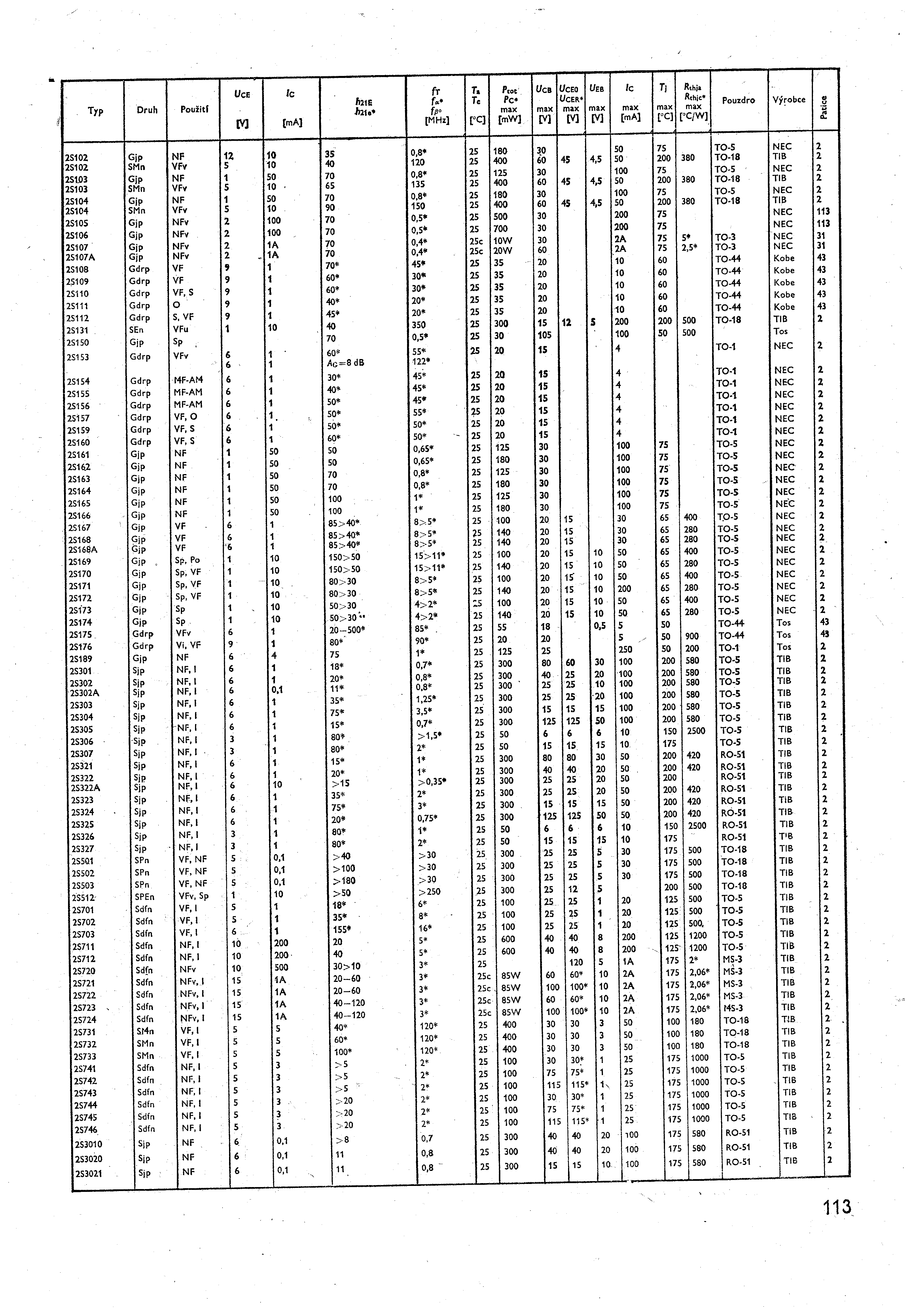

Thanks for the new plugin, it indeed works, but I'm having trouble with it. It runs very slow on full scanned pages, it takes several minutes to process one (I have AMD Threadripper CPU). And when the "Selection to path" bar finally fills, the plugin window hangs ("not responding" appears in the title). GIMP then constantly consumes full 8 CPUs, it happens with 2.10.34 and 2.10.38. When I force close the plugin window, an error message appears, I'm attaching a screenshot. However, it's possible to save the resulting image when I close it. I'm attaching one of the scanned pages, so you could debug it better.
BTW, ImageJ takes about 2 seconds to process one page with that script I posted earlier. After some trial-and-error, I set the unwanted spot size to "size=0-7".

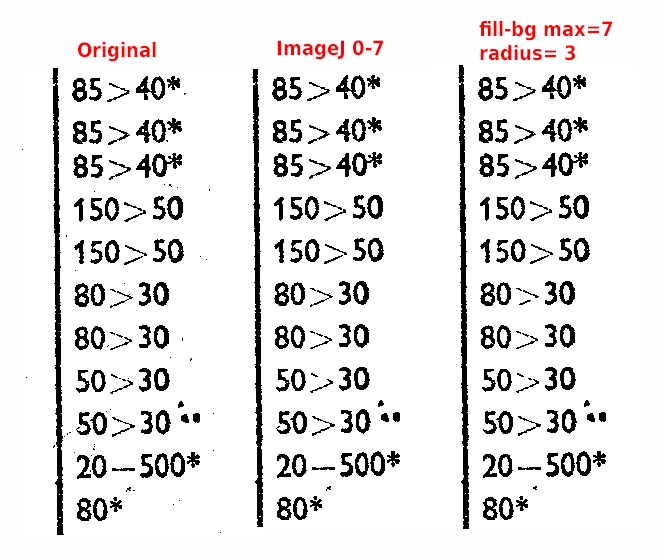

I ran it with threshold 12 and 25 maxpixel setting and it seemed to have removed some of the greater/lesser signs in document. It took like 10 minutes to run on mine on this image (but on mine it took longer than 2 seconds to run on original test image though).
You mean 7 max pixels setting? You can try that setting see if it works better for you. Let me know how it goes.

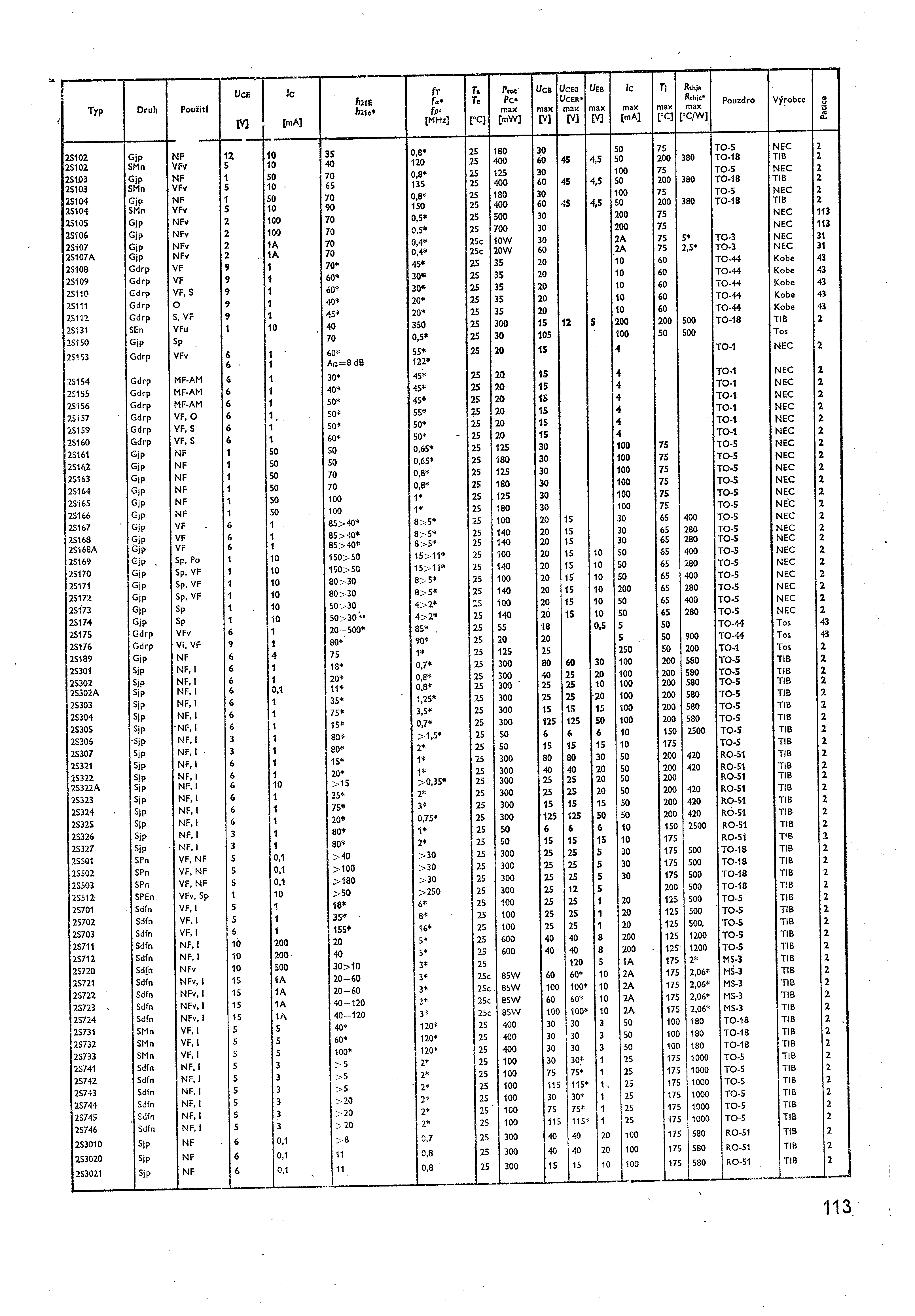

Here's the test result of my 12 threshold and 25 maxpixel setting:
here's the code of the tile processing version:

 Post subject: Re: Remove only black spots in scanned documents?
PostPosted: Fri Jul 12, 2024 9:20 am  (#26)
Joined: Jun 26, 2024
Posts: 8
Thanks, it now finishes without errors, but doesn't work right - it increases size of isolated white pixels which are surrounded by black pixels. This happened in your image too, see the table lines in the upper left corner. I'm attaching output images from ImageJ and your script, so you could compare the result. Spot size was set to 7 in both cases.
In any case, your script is much more user-friendly than ImageJ, but still too slow, one page took about 15 minutes on my PC. I wonder how ImageJ Particle Analyzer manages to run so fast, when it's written in Java, of all languages. I still can't post links, it's on Github in this directory:
/imagej/ImageJ/blob/master/ij/plugin/filter/ParticleAnalyzer.java
See lines 17 to 29, there is pseudo-code that explains how their algorithm works. I have no idea if it could be replicated with GIMP, though.
PostPosted: Fri Jul 12, 2024 2:00 pm  (#28)
Joined: Dec 26, 2014
Posts: 205
It's obvious now my first script was no more than useless, sorry
My second try, the rendition of your full size sample below was done with the script in this zipped folder
remove-black-bg-pixels.zip [914 Bytes]
Downloaded 153 times
The default value of 3700 was used
It took just over 6 minutes
The dialogue box sometimes shows 'not responding', but the script always finishes if left alone
The highest number you can input is 4080, the lower the number entered the more the text is eroded
At 3700 it is starting to erode the '>' '<' characters
The Script can be found at '<Image>/Filters/Remove single black pixels'

Awesome work, fill-bg-less-than.py took only 18 seconds on my PC! That's fast enough even for processing multiple files. It's more aggresive than ImageJ, it removes parts of ">" signs at MaxPixels=7 setting, for example. I had to lower it to 4 to prevent it, but then it leaves some round dots. I'm attaching comparison image. I think it happens because your script evaulates diagonally-touching pixels differently than ImageJ.
There are other minor issues, too. When it finishes, an error window always appeares, I'm attaching it. And unlike previous versions, it doesn't check if the image has correct mode (RGB), it throws error when I tried to run in on source 1-bit files. Would it be possible to make it work directly on 1-bit images, without converting to RGB first?

I have added an extra parameter called within radius.
So it doesn't take out the greater/lesser sign so pixel groups has to be within that radius.
PostPosted: Sat Jul 13, 2024 9:38 am  (#34)
Posts: 4561
I think this one is even better since it won't get rid of the lesser/greater sign as much. since those are shaped unlike a round dot.
This will will generally get rid of round shapes (or where the pixels are within a diameter of a generally round dot).

I tried all 3 versions, but I liked the one with radius setting (from Sat Jul 13, 2024 9:22 am) the best. Although it deletes small parts of the > signs sometimes, it impacts them even less than ImageJ. Fantastic work! The default setting max=7, radius=3 seems to work best, I'm attaching comparison pic.
The other two preserve the > signs better, but also leave more unwanted dots in the image.
Edit: would it be possible for the script to preserve image mode? So RGB input => RGB output, grayscale input => grayscale output and 1-bit indexed input => 1-bit indexed output?

...... the filters fill the insides of number "4", which is highly undesirable. Is there some trick to remove only black spots?
A different approach to the problem of the '4's
find-and-replace-character-4.zip [1.04 KiB]
Downloaded 114 times
The script above tries to find and replace the '4' characters, the full scale sample image below shows one result. All the '4' characters have been replaced but alas with one unwanted error at 2nd column in, 12 up from the bottom
A value needs to be entered, the maximum allowed is 464 but no changes will occur, as the value entered gets lower more of the '4's will be replaced, at 403 the first error occurs and lower values give more errors
In the smaller image below
Left is a crop of the original full scale sample
2nd left, input value was 403
3rd left, input value was 397
4th left input value was 396
On the right the unwanted change can be seen when 403 was used
The downside to this script is that it took 95 minutes to run, If I can work out how Tims getting the super fast speeds that he is I will try and work it into the script, or hopefully Tim might beat me to it
If the script is run on the small png above you can see the result, it takes about 30 seconds
Full page sample character 4 - 85 minutes input 396.png [ 320.33 KiB | Viewed 4655 times ]

Posts: 8
@trandoductin: thanks again, I edited OP to include link to this last version.
@Steve: an interesting approach, but please keep in mind that my aim was to remove the unwanted black dots around the text.
It's inevitable all these "simple" algorithms will always either remove too much or too little. Probably the only 100% accurate method would be to use true AI (or AGI), i.e. a tool that would understand what the text actually means. Or what it's supposed to mean, in situations when the print quality is so bad that characters' fine details are missing. That happens frequently with the > signs, asterisks and degrees signs in "my" documents...
