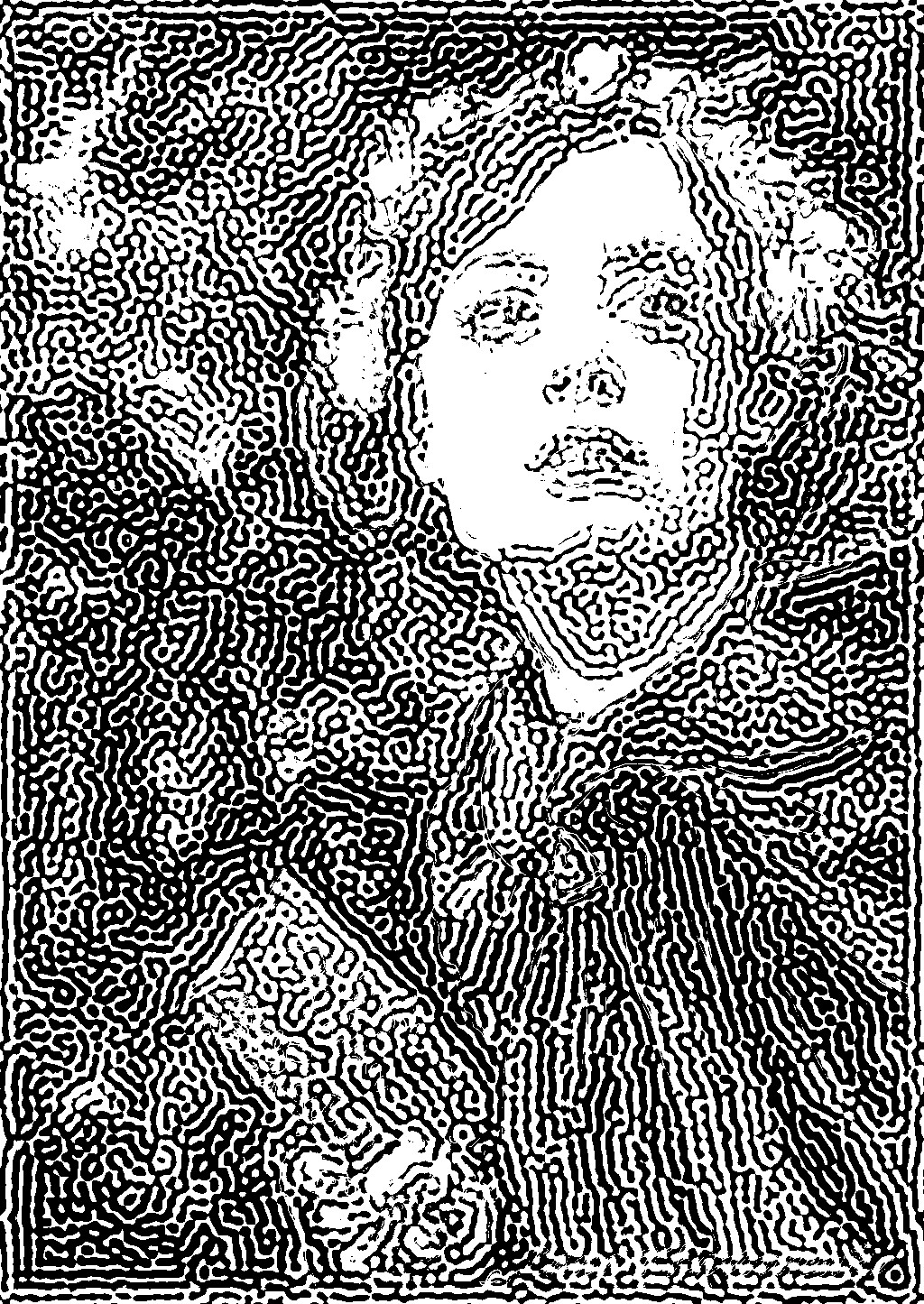

For those of you who think that I cannot spell 'Head', a Hedcut is a style of black-and-white drawing popularized over the years by the Wall Street Journal. Inspired by the Stipple/hedcut portraits thread in Photo Enhancements, I set out to make my own hedcut filter, based in part on that discussion, also based in part on my desire that the faux inkwork should trace the geometry of the underlying image, and also based on my whimsy that the style should also be akin, yet distinct from the WSJ. Close to my thinking are the copper plate etchings that served newspapers and periodicals in the decades before the halftone process became common. The everyday examples which survive are the portraits of people printed on currency, such as the presidents on U.S. Dollars.
Here is a representative reworking of Patrick David:
This glass plate portrait of Jean Cocteau served as my initial test image:

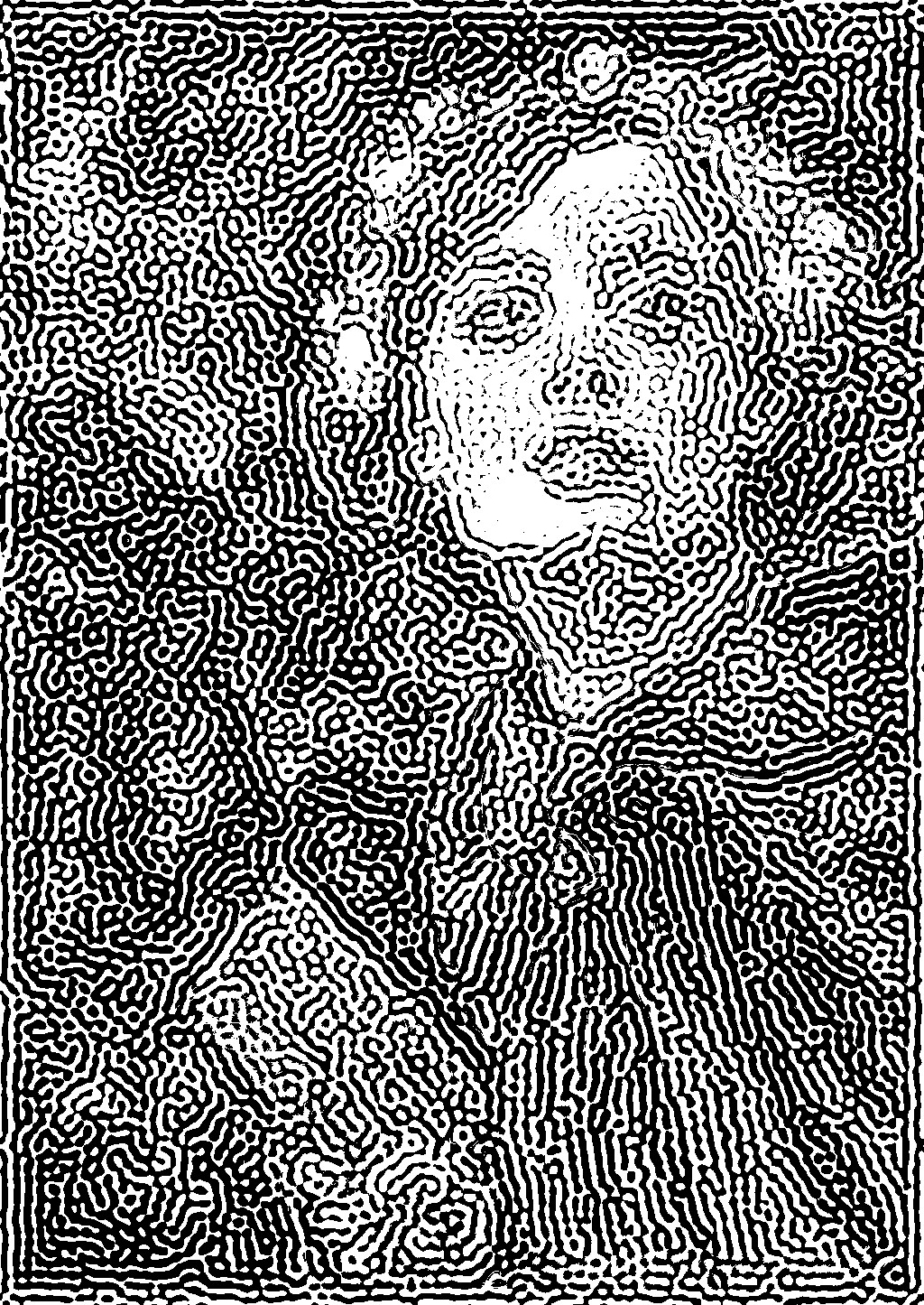

Patrick David's blog is how I learned about G'Mic. Can't believe I haven't heard about it before now.
I couldn't get the fine detail in the above pics. Buster Keaton:

I see that Mr. Keaton is very dark.
  1. I suggest enlarging the image 200% as a pre-step. That was how the fine detail on Pat David was obtained: I worked oversize and then reduced after running the filter.
  2. Pattern->Size: Initially accept the default of zero (smallest detail the filter is capable of).
  3. Photometric->Luminance Level: I would raise it to greater than 0.5. Raise it to a value when pattern disappears in highlights, then back off a bit. Jean Cocteau was around 0.6 luminance.
  4. Photometric->Contrast: With luminance set so that the pattern is almost like hairlines in the highlights, I would then increase contrast so that the pattern almost, but not quite entirely disappears in the shadow. Jean Cocteau was a little over 0.7 Contrast.
  5. Pattern->Smooth/Pattern->Size: larger values on both these controls makes the pattern less turbulent and more likely to follow edges and image features.
The link to "Particular Art: The Gimp Hedcut Filter" has notes on workflow, which may help.
Thank you again for testing.

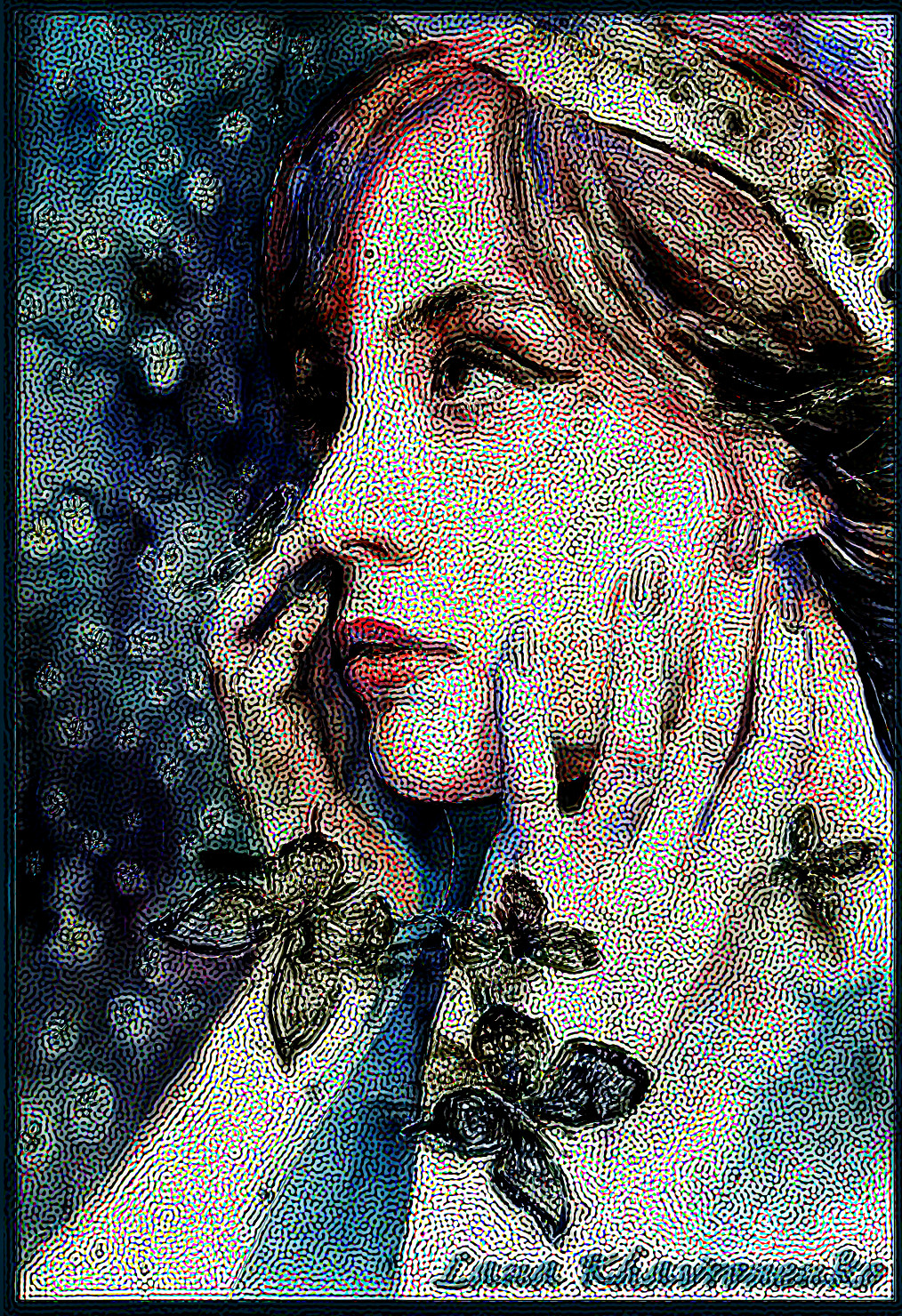

new experiment, by combining FingerPainting and Hedcut
original (DeviantArt)
experimental outcome

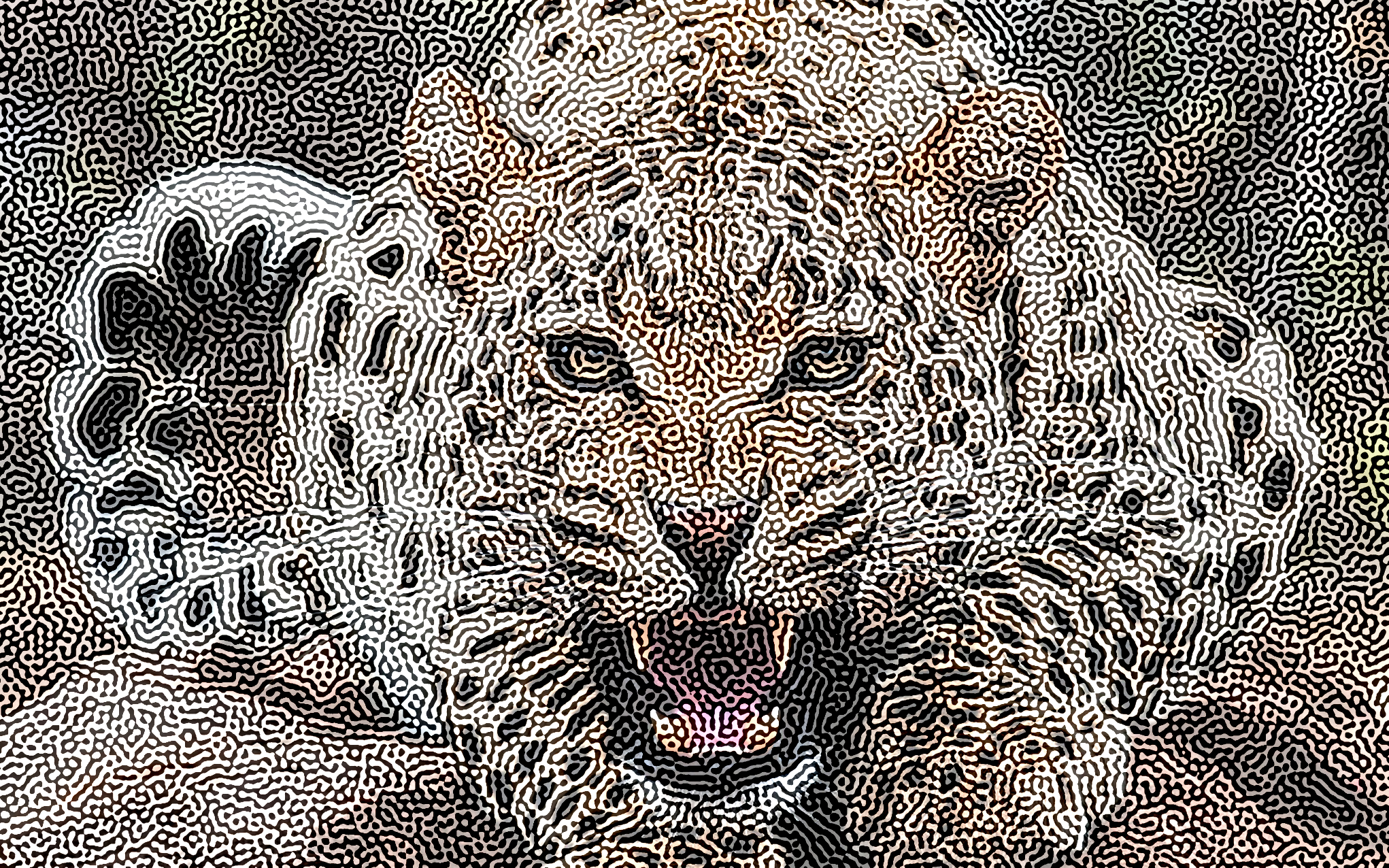

Testing this out. :)
I wish the lines could be made smaller?
 Post subject: Re: Hedcut: A New Experimental Gimp-G'MIC Filter
PostPosted: Fri Mar 06, 2015 7:24 am  (#13)
Rod,
double the image before applying the filter then downsize it back
PostPosted: Fri Mar 06, 2015 7:25 am  (#14)
Posts: 16322
I enlarged by 200% and used the original on Grain Merge mode.
PostPosted: Fri Mar 06, 2015 7:26 am  (#15)
that looks good, doesn't it?

Somehow a leopard seems especially appropriate for this toy; especially since the pattern rather imitates leopard spots. I like the outcome.

Laura Khavronenko's line work also triggers a lot of pattern alignment and seems apt for it. Her bold color palette seems to hold up well with Hedcut, which can dull color quite a bit. I'm not sure Hedcut is a color tool, but these paintings you've filters argues strongly otherwise.
Nice work, everyone. Thank you very much. I've thought a few other ways to apply this filter in color texturing work, where its presence is not so obvious. Perhaps I'll post some examples that I have in mind later today.
