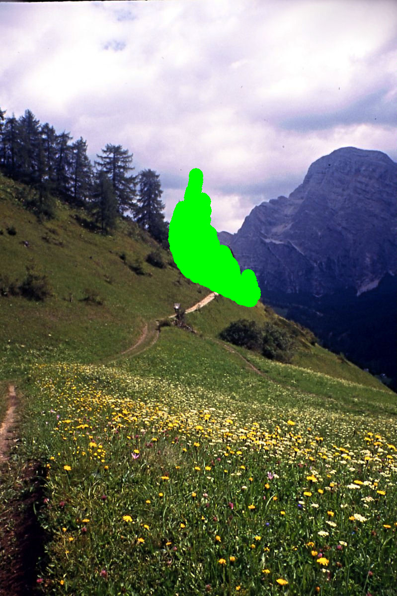

please, have a look at this new example (normal picture)
still the left side looks wrong

Hmm it's quite possible with some pictures this will always happen, due to an area of much lower gradient.
Anyway, I've made a small adjustment so that removal alternates where gradient is constant... this should be available to try under "testing->garagecoder->seam carve [fast]" but be aware this is a stripped down version with no support for priority mask or anti-aliasing - it's only there to test the checkerboard problem.

Hi Andy.
I tried you updated version (under test) for the enlarging mechanism.
It looks better, but there are still (serious?) problems: look at the church-steeple.
I hope you and David will sooner or later provide a version usable for actual photo manipulation.
Anyhow, thanks a lot for your support.
