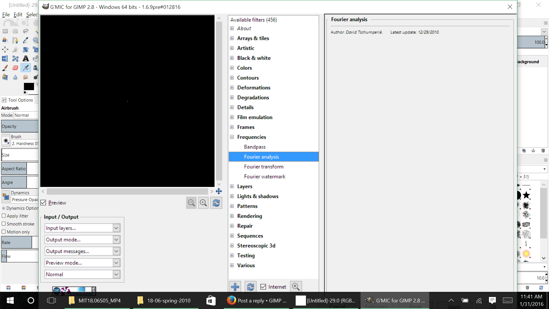

Hello,
I signed up for this forum for a bug I found on G'MIC for Windows, and this is my first post.
It is a very tough bug to deal with, as it makes it so that I can't use G'MIC on many images (the GIMP plugin, at least; haven't tested standalone).
What happens is that the window is too large to fit on the screen, and is not, in any way resizable.
This was also the case for the current stable version.
It seems to only happen on GIMP-generated images with a height larger than ~400 pixels.
The taller the picture is, the higher the preview is, the more the bottom buttons disappear.
There are some pictures that do not exhibit this behavior, even with the above conditions.
GIMP 2.8.16 - Windows 10 64-bit
[Attached is a screenshot, and a sample image that exhibits this behavior]
File comment: Example image that makes G'MIC g've up.

@snelltheta In the GMIC window, there is a box at the bottom of left corner that right now says "Normal". Click on that box and select "Small"

Thanks for reporting snelltheta,
This morning, I've added some code in the plug-in to check that the dialog window is entirely visible on the screen.
If not, the size of the preview widget is reduced as much as possible.
I've just posted some new pre-release binaries today with this fix included, available at :
http://gmic.eu/files/prerelease/
Could you re-install the plug-in from today, and check if that fixed the problem you had ?
I'm looking for your feedback.
Thanks !
Thanks !
New plugin works good, thanks.
