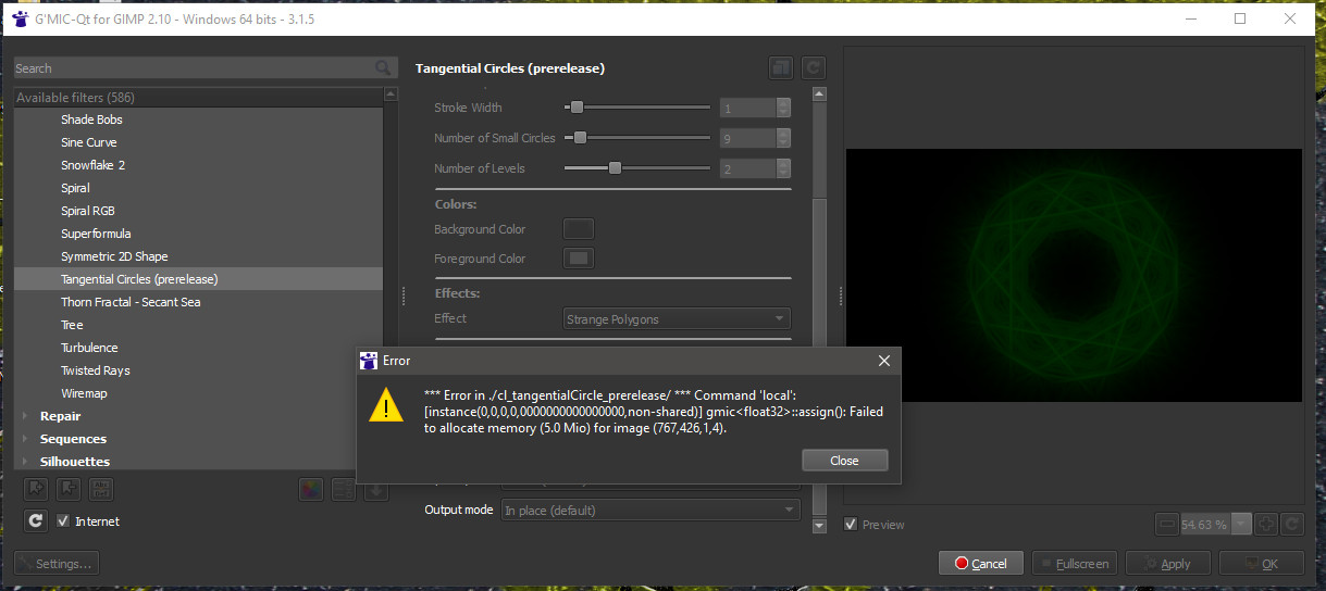

I wonder if it's because i only have 500 MB of RAM on this Dell laptop. Can't be because of hard drive space as i have 42 GB of that.
:hoh :gaah
Image (thanks @Krikor for this emoji, I love it)
Yeah... 500MB that's not enough IMVHO, my pentium 4 had 512MB of RAM... it was something like 18-20 years ago.
When I run the filters from Claude (cli345) I can see in G'MIC (at the bottom) it reaches quickly 1 to 2 GB, even more, (OK with my modification, but others filters do the same)
If i recall, or it's something my mind made up (if so, my following sentence is all BS), the swap (by default) is the size of the RAM or double the RAM, thus it won't use the 42 GB... unless you physically made the swap this size. And if you drive is a HDD, what's its spin 5.4k or 7.2k?! it's very-very slow compared to a SDD.
G'MIC might throw error because it's too long (this latest sentence, though, I'm sure is all BS :mrgreen: )
Patrice

[...]now i have no nifty design[...]
I've just added an option to the "Dimensions" parameter: "According to Layer (Scaling)".
(If you choose "Proportionate" or "Scaling", the big circle radius is a percentage of 1/3 of the smaller dimension of the layer. Otherwise, it's a number of pixels.)
Is the error still present with this option ?
Yes
