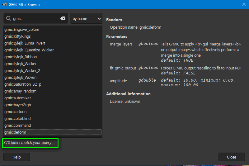

Further problems to diagnose gegl-gmic:
1. Filter packs 1-9 contain 374 filters.
The GEGL Filter Browser displays 370.
Does anyone want to determine which 4 filters are unacceptable?
2. The GEGL Filter Browser crash reported by the Batcher author.
For me, this only confirmed the problem with the gmic:jejescandoc [gmic-jeje_scandoc.dll] filter, which, strangely enough, seems to work fine when accessed from the GIMP menu.

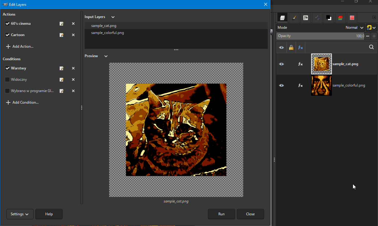

PostPosted: Sun Feb 08, 2026 7:31 am  (#24)
Kamil Burda released Batcher 1.2.1, which quickly resolved the reported issue.
It now works very well for me.

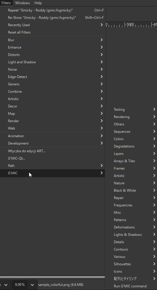

Another filter pack.
Of the 61 Reptorian filters generated by Contrast, 38 seem to work well in Win10.
In menu: Filters ➤ G'MIC ➤ Testing

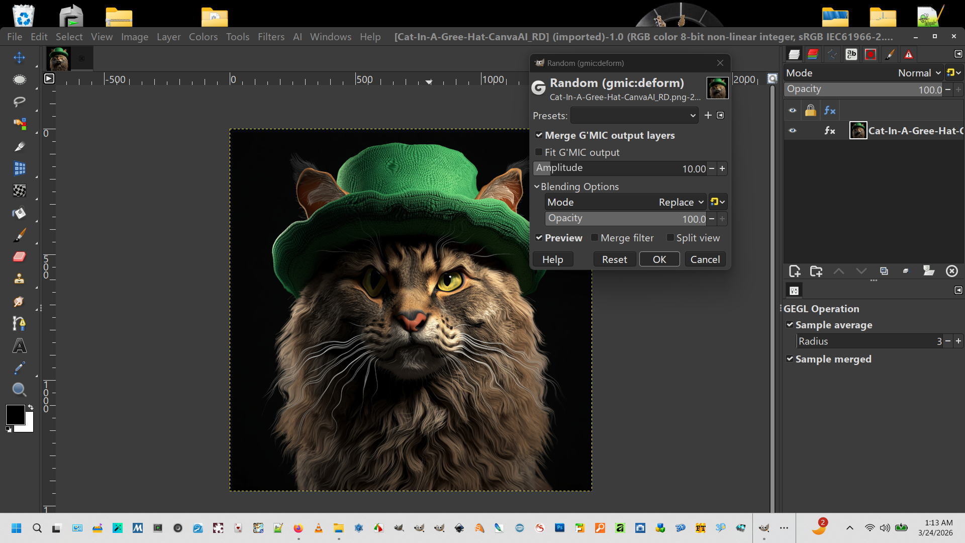

They work in GIMP 3.0.8 version 2 for G'MIC.

2. The filters retain their categorization (except for the Testing group, which lacks author categorization).
3. The first tests showed that more filters will work.
I'll leave it to users to test these filters.

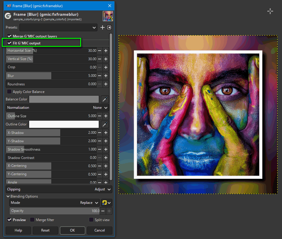

Please note that some filters will require the Fit option to be enabled.

https://github.com/flatscrew/gmic-gegl- ... /STATUS.md

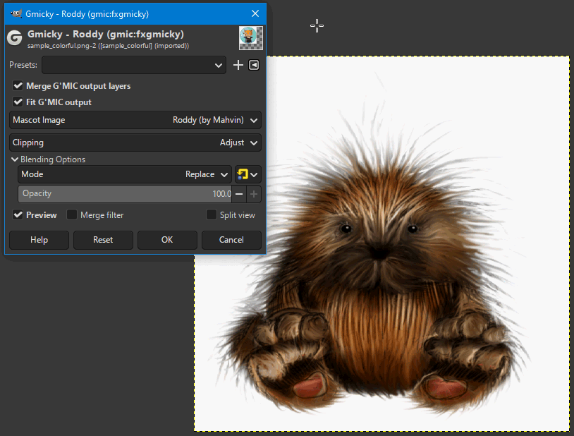

A small detail:
For the Gmicky filter, the category entry was in Japanese. I changed it to G'MIC/Rendering/Gmicky - Roddy.

Can any Windows 11 user verify the functionality of the example filter in a brand new compilation [gmic-deform.dll]?
For Gimp3, go to Filters/G'MIC/Deformations/Random.
In Win10, it works from Gimp-2.10.38 to Gimp-3.2.0 (no dependency on libinitl-8.dll).
The latest libraries from gmic_3.7.4_lib_win64 for Gimp-3.2.0 are in bin.zip [libcgmic-3.dll, libfftw3_threads-3.dll, libfftw3-3.dll]
bin.7z [4.15 MiB]
Downloaded 141 times
