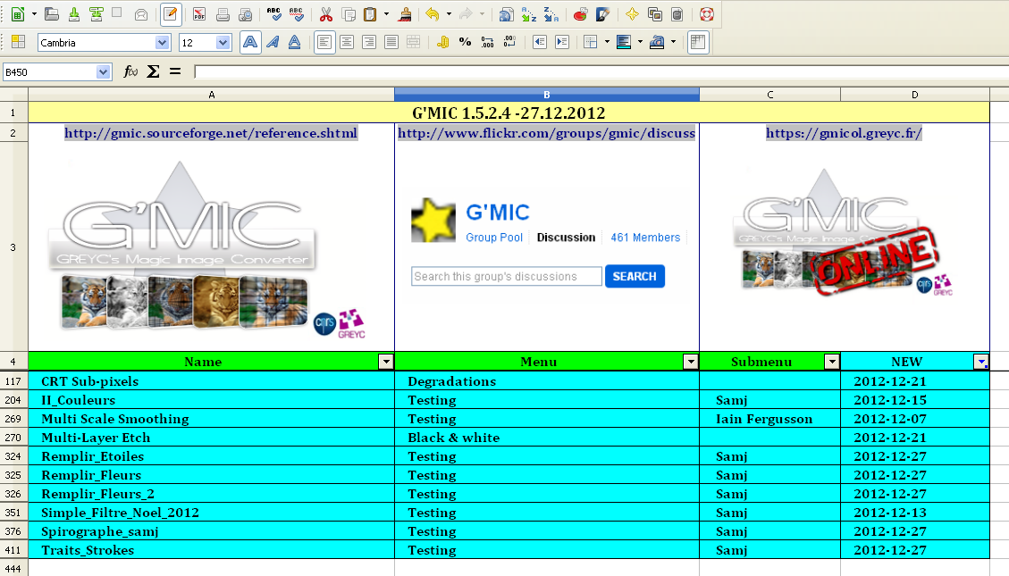

Small update - as at 27.12.2012.
Two files - for Excel (xls) and LibreOffice (ods).
Marked a new filters - blue color.

Now, I only see the new files and not the old. I used an online ods convertor (haven't re-installed Open Office since I upgraded to Win7) and it only showed the old presets and never the new. How do you get your preset to show all the updates MareroQ? Do I need to re-convert the ODS to XLS and merge everything somehow? Just curious. :)

Lyle, Here's an xls file with the original 12.12.12 version and 12.12.26 in a new workbook. I hope that helps.
File comment: XLS - v12.12.12 plus v12.12.26 update
GMIC-Alphabetical list of filters-updated.zip [220.3 KiB]
Downloaded 185 times

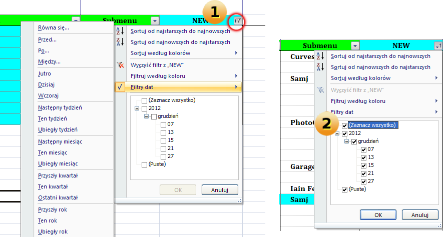

I in this sheet used option "Autofiltr" - to it can will sort easily (according to numerous criteria) and to find.
Click (1) and mark all (2)
Doesn't this work ?
ps. Samji - is great - new filter - update (28.12.2012)
pss. Removed redundant old file -a newer version of the spreadsheet is the end of the story

With these spreadsheets from MareroQ how do you add additional entries in the correct alphabetical order, I have no Idea how to use spreadsheets.
But I would like to try and keep mine up to date.
 Post subject: Re: Alphabetical updates for GMIC
PostPosted: Sat Dec 29, 2012 3:51 pm  (#40)
Are you using Excel or OO Cal? They both have a sort option so you can see all the GMIC filters in MareroQ updated list.
In Excel use the filter drop down to the right of New, check Select All, OK.
MareroQ shows the Excel filter, have a look at his graphic.
viewtopic.php?f=9&t=5973&start=30#p75829
In OO Cal, use the Name drop down, select Standard Filter...
Change NEW to Name, Condition =, Value - not empty -, OK.
