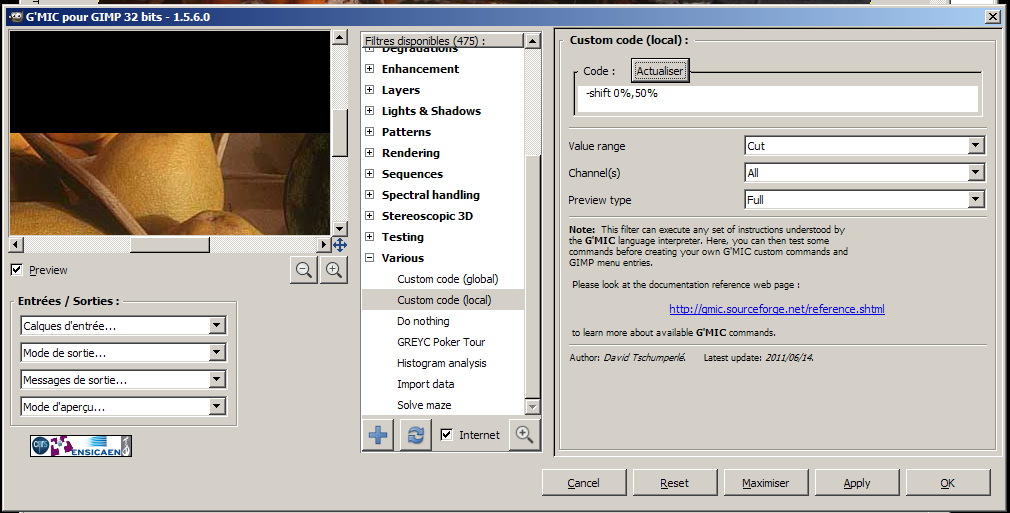

Are you using DOS command line by any chance? I'm wondering if an unexpected substitution is happening, since DOS uses "%" for some things.
 Post subject: Re: G'mic documentation (Reference Manual)
PostPosted: Tue Jun 04, 2013 5:07 am  (#22)
no, the command was experimented inside gimp, using gimp-gmic
PostPosted: Tue Jun 04, 2013 5:09 am  (#23)
ps
my environment is win 7 32 bits
edit: and was done using gmic 1.5.6 beta, I will try to reproduce it on the stable version downloaded yesterday

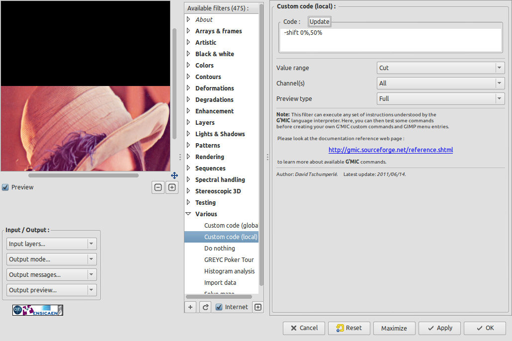

Like this ?
(Tested on Ubuntu / Linux 32bits).

Joined: Jan 03, 2011
Posts: 1656
Just tested on my Virtualized XP, and it works as expected too.

ok, I'll check on the stable version (obviously I don't have any more the beta version...)
PostPosted: Tue Jun 04, 2013 5:40 am  (#27)
checked, now it's OK also in my env with stable 1.5.6.0
don't know whether the beta I had previously was somehow involved, what I can tell you is that I tried many times, and with many different percentages, which ALL worked EXCEPT 0%
so, now good news also for myself!
