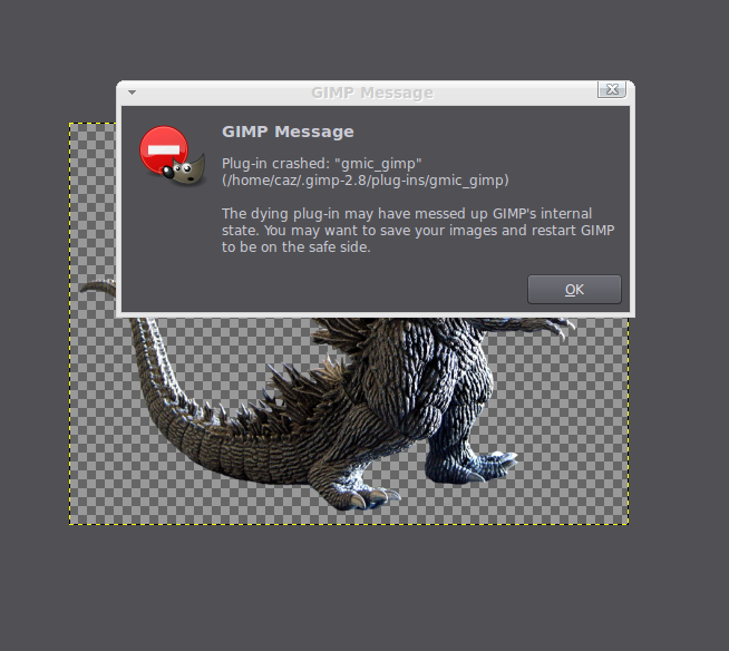

I just updated the filters list and G'Mic now crashes when I try to run the Rodilius filter, I didn't actually get a chance to run it as the crash happens as soon as I hit on the Rodilius link in the filters list.
I tried a few of the other filters and it appears to run them okay, dream smoothing was one and smooth anisotropic was another.
Though it was best to post the results of my updated G'mic install.
Running Linux Mint 15.
Worse results for me, as GIMP core dumps as soon as Rodilus is selected. Running Fedora 19 (x86_64).

gnutux : did you try to install the latest version (from today!).
 Post subject: Re: Parallelization in next G'MIC [1.5.7.0]
PostPosted: Fri Aug 30, 2013 1:38 pm  (#30)
I'm using 1.5.7.0 Beta (x86_64). Perhaps the 64bit version has not been updated.
This is the error I get when I select rodilus..
*** Error in `gimp-2.8/plug-ins/gmic_gimp': double free or corruption (fasttop): 0x00007f926c0780f0 ***
/.gimp-2.8/plug-ins/gmic_gimp: fatal error: Segmentation fault
PostPosted: Fri Aug 30, 2013 1:49 pm  (#31)
Joined: Jan 03, 2011
Posts: 1656
yes, the 64bits version of samj has not been updated today.

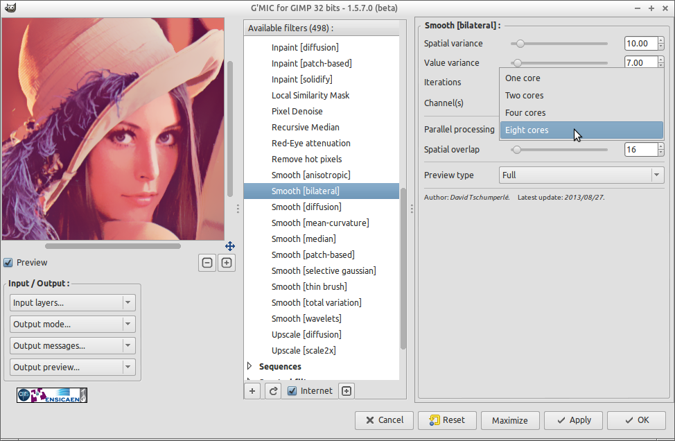

PostPosted: Mon Sep 02, 2013 10:25 am  (#40)
Posts: 1656
Updated filters to allow the use of up to 8 cores for parallelized filters.
Anyone able to check the speed gain, if any ? :D
